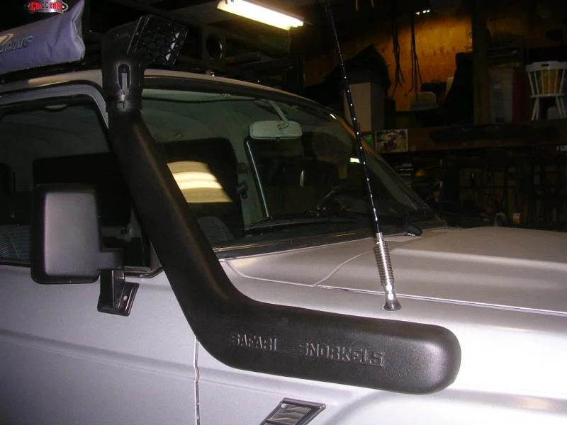

My factory antenna had been heading for the trash can for some time and bending it more while I was installing the snorkel was the final nail in the coffin. Add to that the frustration of my old magnetic mount CB antenna and the foundation was laid for a new combo antenna.

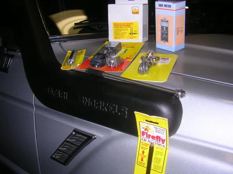

So...a visit to Wagongear for an antenna mount,
Antenna Mount
and a little shopping spree at Walcott CB Sales online store and I now have my new antenna installed.
I won't bore you with a detailed description of the install, Kevin has an excellent write-up on his page. The install included Kevin's bracket and rod, a 4' Firestik Firefly antenna, spring mount, Fire-Ring w/ coax cable, AM/FM-CB splitter and an SWR meter so that I can tune the thing correctly.
The only part retained from the original antenna is the rubber grommet at the fender. Mine disintegrated so I robbed one from another car but I would really like the correct one so if anyone has a spare they like to send me, let me know.

It may look aesthetically good, but that is not the most ideal location for the antenna to get the best range off of the right front corner of the truck.
So, where is the "most ideal location for the antenna to get the best range" on an FJ60?
The best place for optimal groundplane effect is center of the roof but that's not practical for me with a roof rack. This works very well and it does look cool too! :cool:
