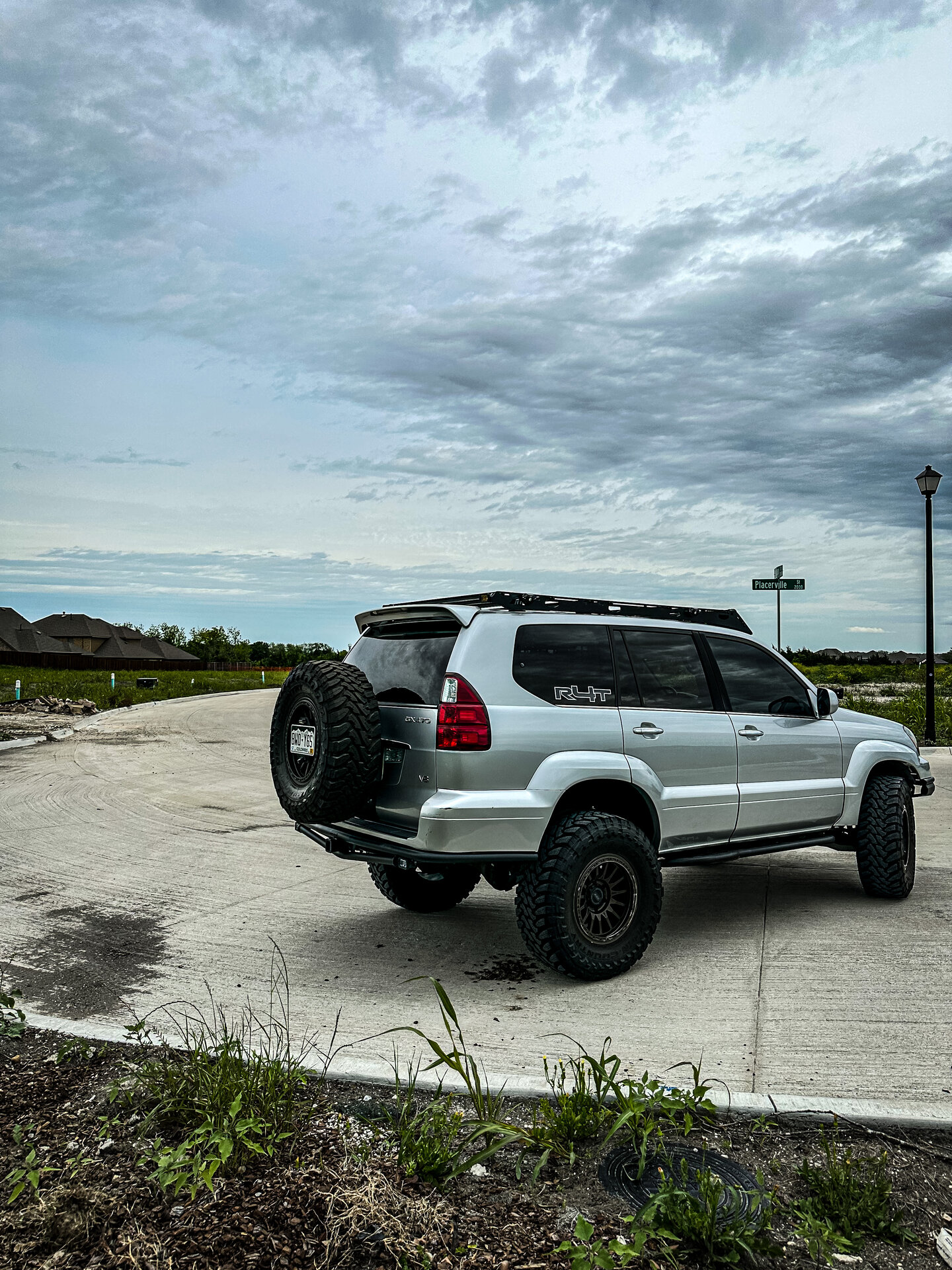

New to the site and new to the Prada platform but not new to Toyota. Finished my 5th gen build and wanted to build another vehicle.
Current build so far:
Suspension:
Front:
SPC UCA
Dobinson MRR
Durobumps Bump stops
CVJ axles
Rear:
Dobinson MRR
Dobinson adjustable rear lower control arms
Dobinson adjustable rear upper control arms
Dobinson extended rear swaybar links
Dobinson adjustable panhard
EimKeith panhard correction bracket
Brakes:
Stoptech rotors and pads
Extended rear brake lines
Wheels/tires:
RRW R7H 17x9 -12
315/70/17 Toyo Open Country MT
Armor:
RCI full skids
R4T front LCA skids
R4T front bumper
R4T rear bumper
R4T sliders
JW rear hatch tire carrier
Nice clean build.

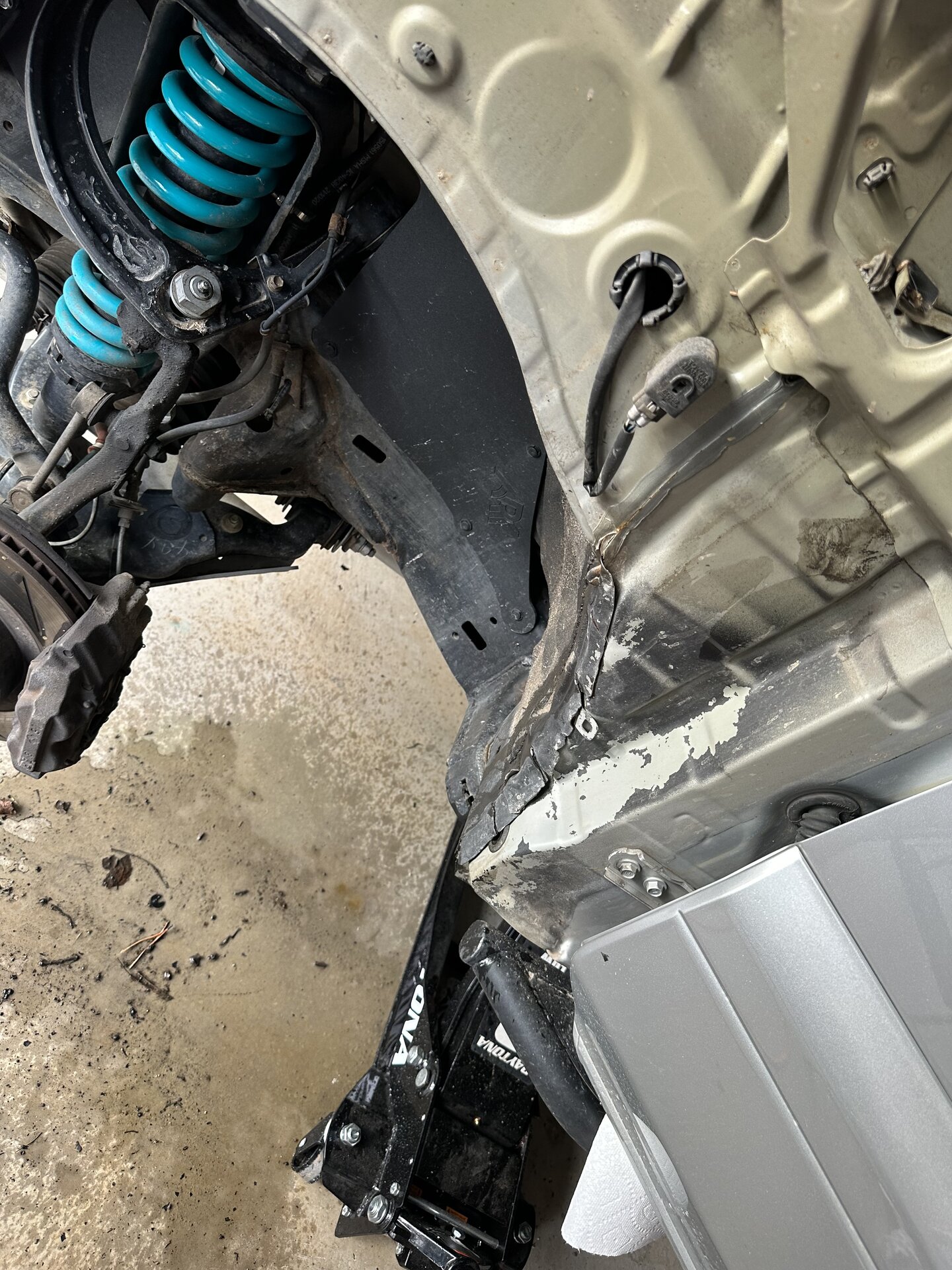

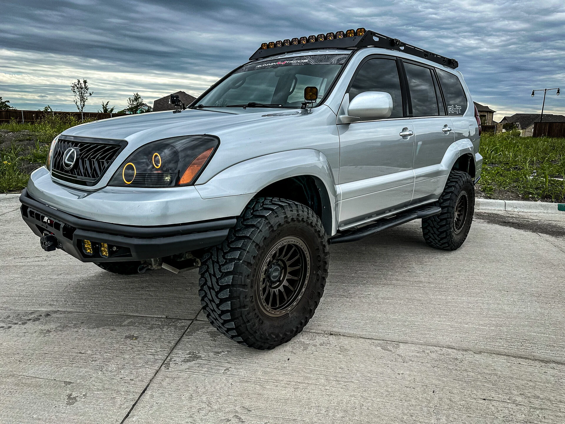

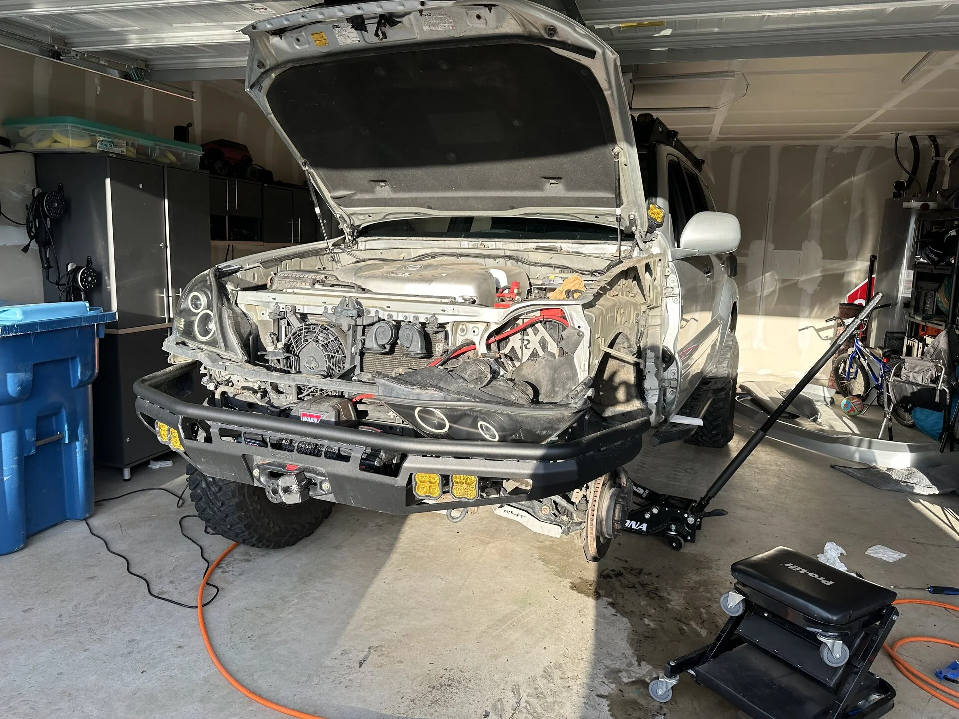

In the front, what else did you change? No sway bar? BMC and hammer the pinch welds?
I’ve been looking at the R4T bumpers. How you like them?
Nice clean build.
I’m still running front swayba, BMC, pinchwelds and a lot of hammering. Still working on the clearance. Tubbing and body mount relocation is the way to go.
