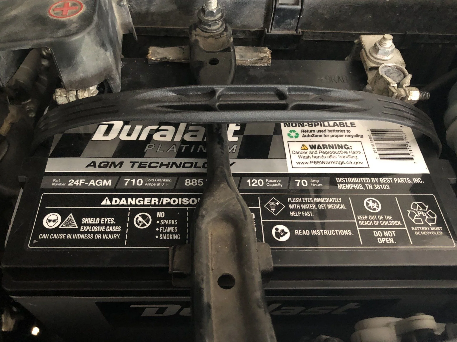

Here’s a picture of the new battery . Hopefully they sold me the correct battery.
Try jumping it to be sure it’s not a lack of full battery charge.
If it still won’t turn over, you may simply have a dead starter. Starters routinely die on Lc’s after roughly 7-10 years...100-120k or so.
