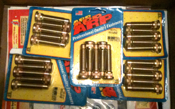

ARP 1007718 - ARP Wheel Studs
A few days later, ups drops off one expensive box of bolts. In the link above you will find some other alternatives, but I liked this one as the knurl size was 0.565 vs 0.563 stock. Micro larger knurl seemed good to me if I could not get exact.

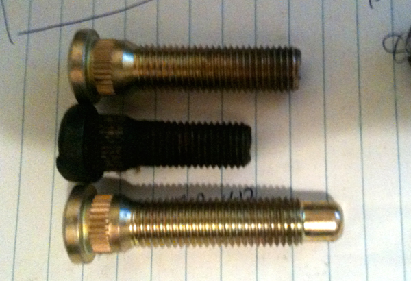

Now for the mod. On the rear I measured that I would have just enough room to fit the whole thread into the Lug, but just. So, Off with the nipple.

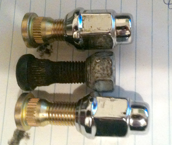

Photo of my test bolt top, stock center, new with nipple in tack bottom.
Lug bottoming out on nippe-less stud, middle, stock stud with open-ended lug, sitting about where it sat with new rims(a few threads unused), bottom lug bottoming out with new stud with nipple. You can tell I might of been able to get away with leaving the nipples on the back, but I did not like it being that close to bottoming out, and chance getting a fake tightness.

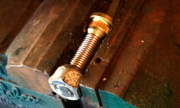

I used the opened lug to guide my cut off wheel.

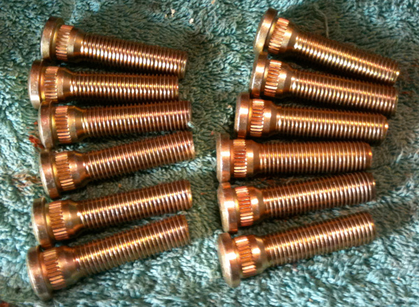

12 studs in a row, (just like Dom likes.)

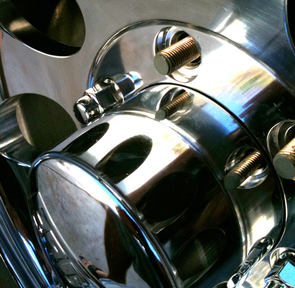

The fronts have a diameter and a half (full open lug thread use) being utilized, but I plan on swapping them out the next time I repack my bearings. I will just feel better having more tread usage than just minimal.
