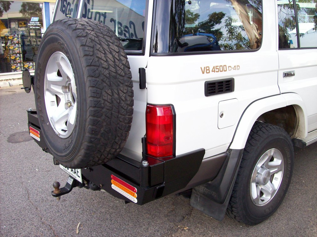

Yes ,I was looking at my rear ARB bumper with twin tyre carriers and each corner has a sturdy eyelet for a shackle. I post up a pic later.

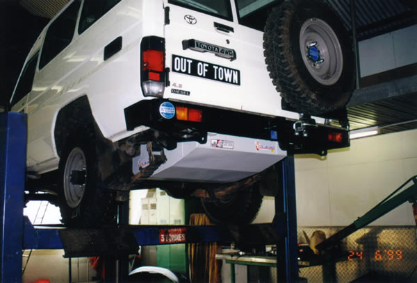

I said I had a ARB rear bumper, its actually a Kaymar sold through ARB . Not my troopy but very similar bumper design. You can see the 2 recovery points.
The advert was meant to be for the longranger fuel tank.
