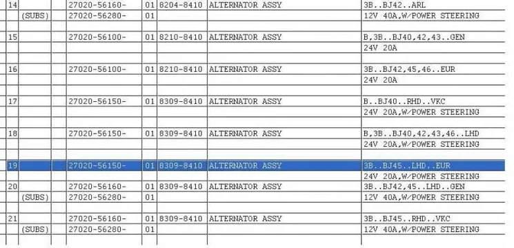

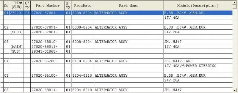

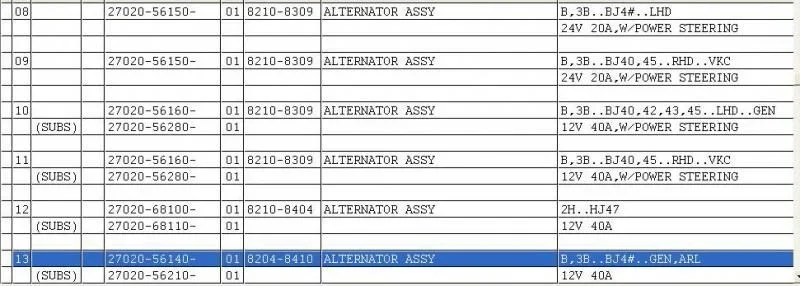

The parts manual list the BJ70 as having a 40a,50a as well as a 55a
Was there a 3B at all in the 1970s? I thought the 2B was introduced in 1980 and the 3B in 1982

3B alt is 40 amp

Rob's correct.
The last of the BJ4# series (mid eighties) didn't get more than 40A output:

Its a bit vague,it has one diagram for all including including the 13BT.
The Coasters have some larger alternators including a 24v 85a and it also mentions parts for 12v 80 and 90a alternators,but not the alternator itself.Might be a mistake.
