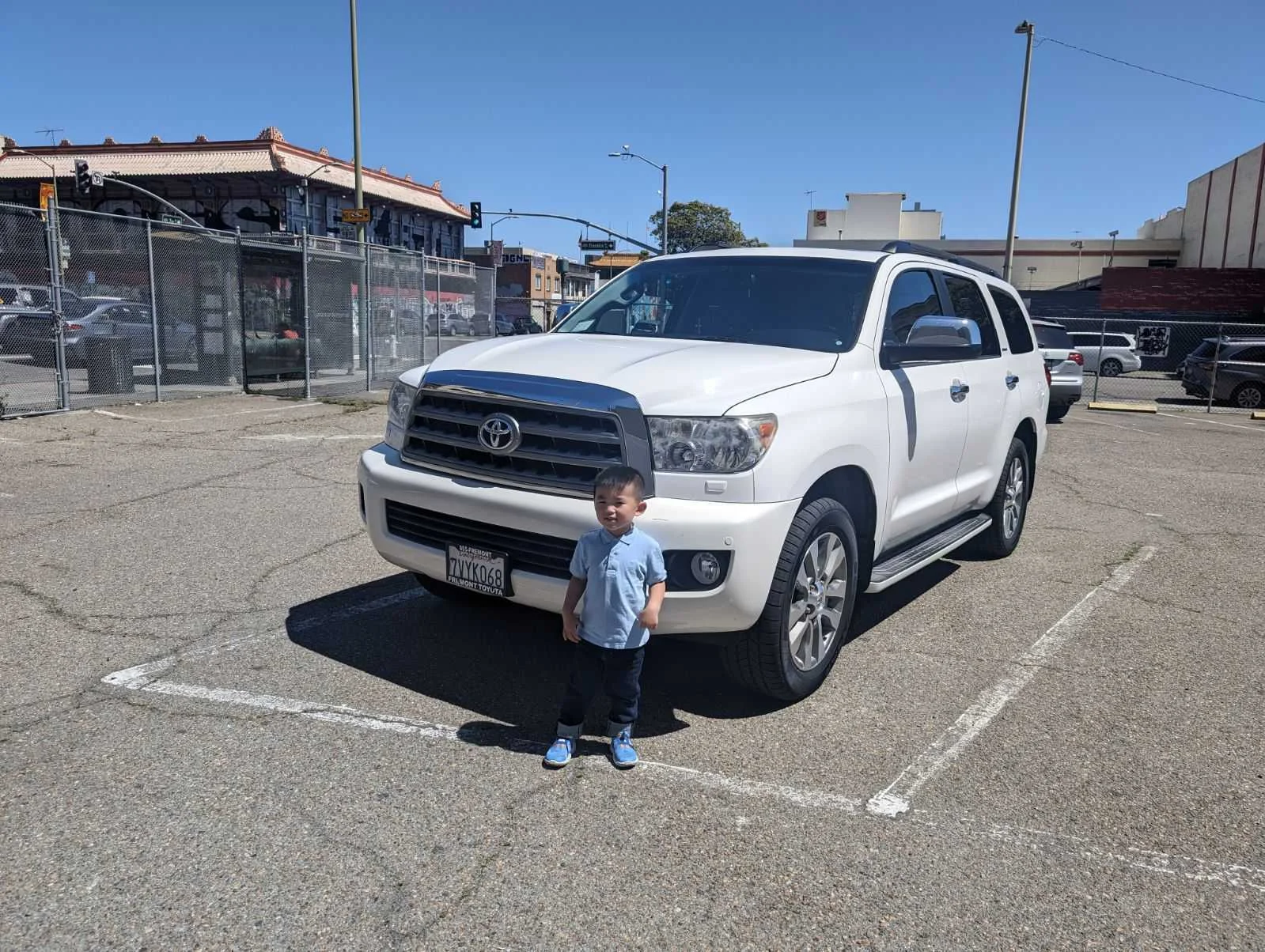

Hi all, just joined and wanted to do a short intro. I just purchased a 2017 Sequoia Limited 4x4 with 83k miles. This is my first large truck/suv coming from a RAV4 so this a huge difference/upgrade for me. It's so much nicer to have all this space. I like to do a lot of outdoor stuff like fishing and camping. Once in a while, some of my friends go camping in pretty secluded places that require off roading so this will be nice once I get it lifted with tires.
