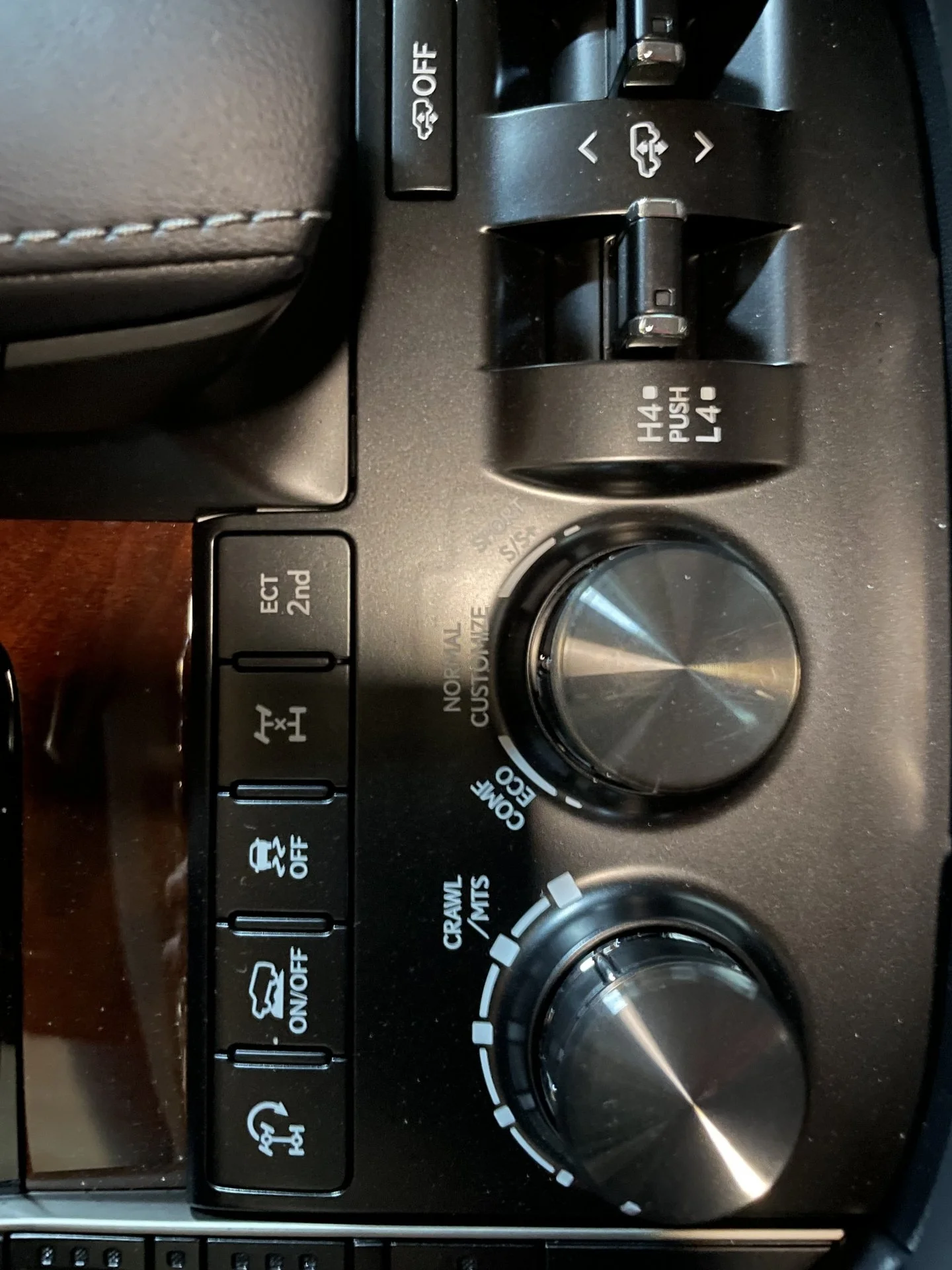

I have found that the adaptive cruise works better if my ‘14 LX has the ECT power button on. Less searching for gears but does the 21 still have the power button?
There is a ECT 2nd button, see pic below. Is that what you mean?
