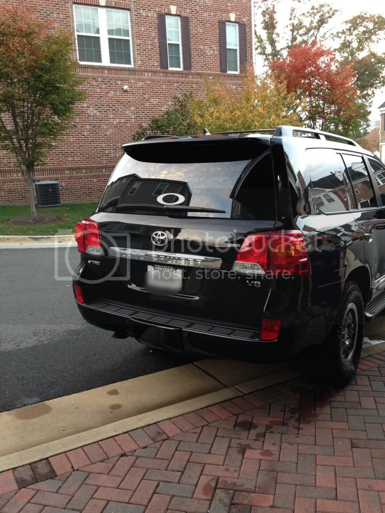

So i've been getting some requests to post up some pictures of my new rig. so here it is 2014 LC200 black on black. TRD Forged wheels, with Toyo Open Country ATII's(all 5 including spare) with new TPMS. Tinted windows and full interior LED's, yellow lamin-x on fogs

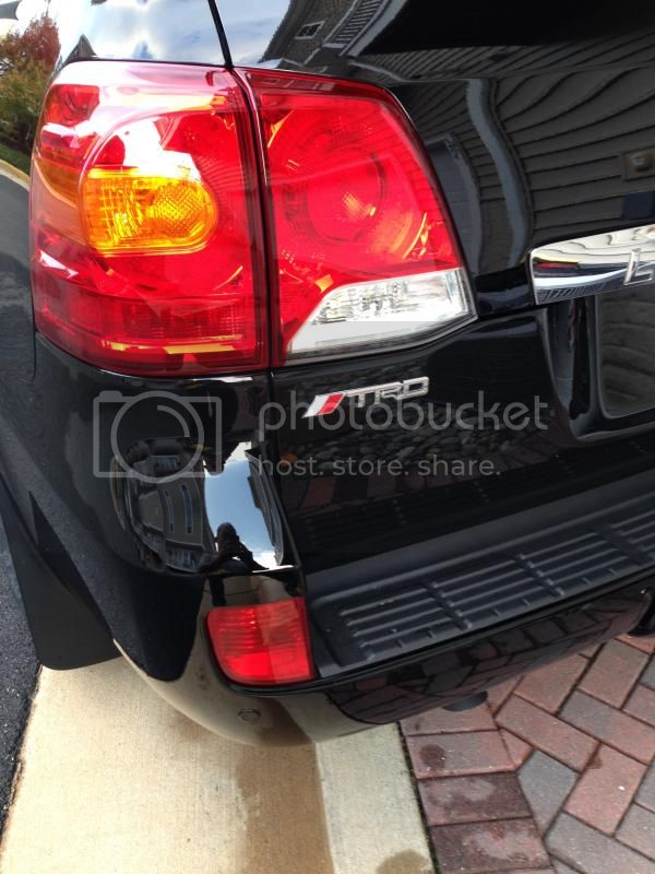

So upon delivery the paint wasn't in the best shape, probably sat at the dealer a while on lots and lots of swirls. here's after just one fender using the clay bar
I did a complete detail on the exterior, i got away with a one step paint correction and it is about 95%. i two stepped a few areas and got it to 100% swirl free.
