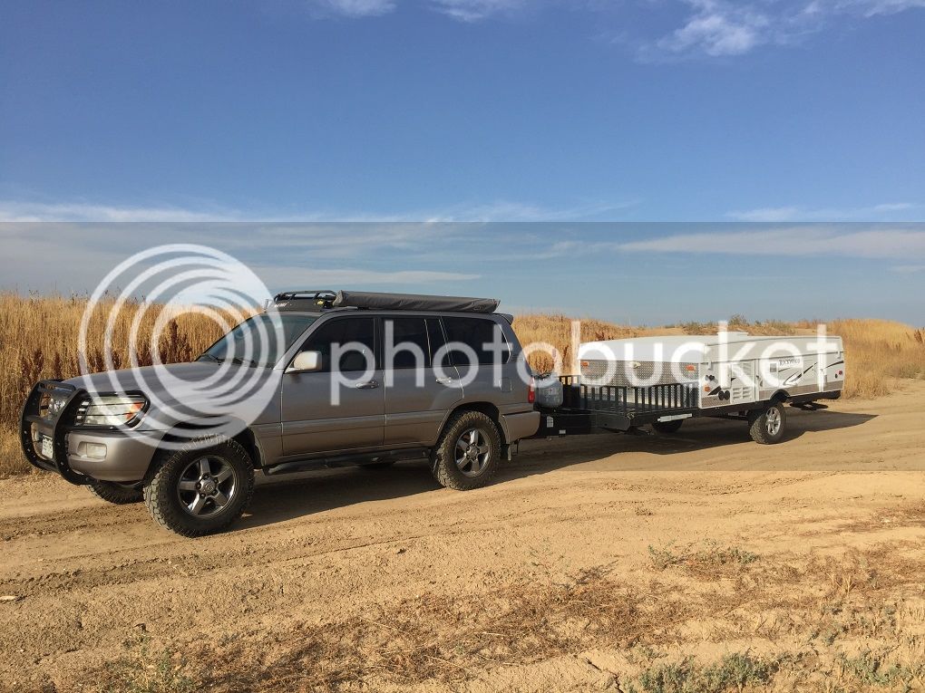

275/70-18 Nittos TG heavy duty load range
▲▲not regularly towed▲▲ .................................. ▼▼regularly towed▼▼
Thanks for the pics Phil, anyone running the Kuhmo AT51? 10 ply and some great reviews on tire buyer and discount tire.
