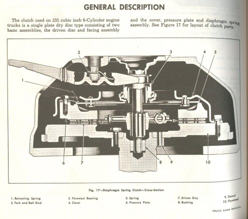

Here's a cross section showing the whole setup

That looks right to me. :confused:
Of the parts you replaced, do you still have the old to compare to the new?
You're sure the release bearing the same length?
Is the ball stud the same length? Is it tightend all the way?
Is there a difference in the length of the fork and/or the distance to the fulcrum point?
