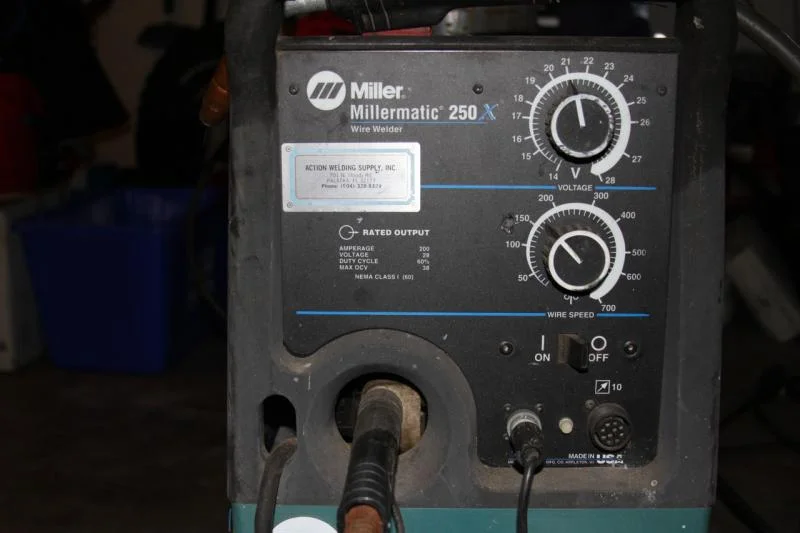

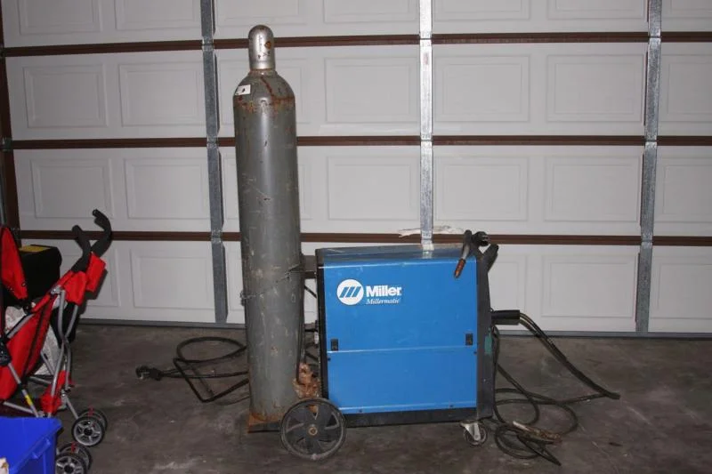

Well I got a new (used) welder. I could not pass up this deal.

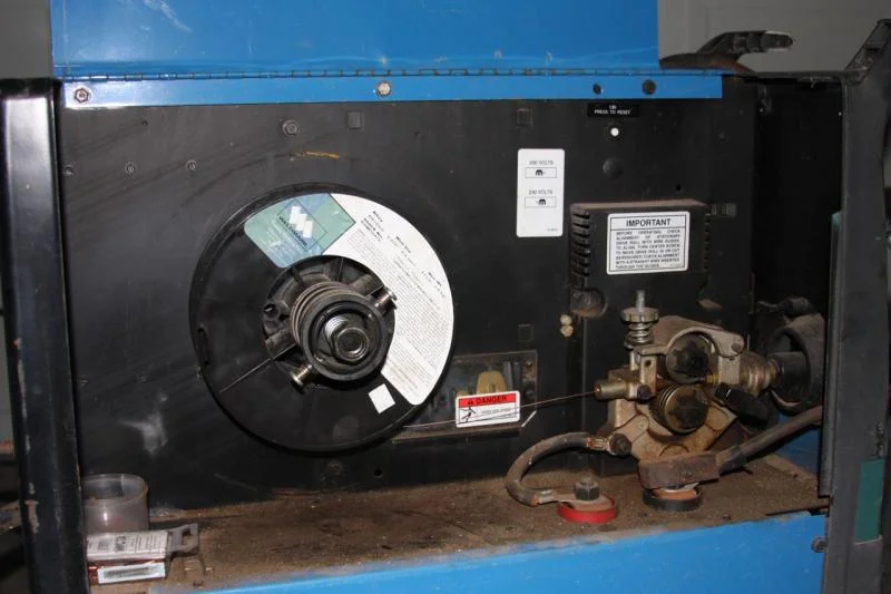

Came with tank of CO2 & Argon, plus a spool of .035 wire. I'll be wiring it in this weekend and hopefully laying down some nice beads. I'm going to clean it up and give it a mild service before I light it up. however it looks in pretty good shape.
The guy i purchased it from used it to rebuild his car 5 years ago and never used since.
Its a Millermatic 250x made in 1999. I know some of you say the 250 is not a good machine however its going to blow the pants of my old chicago electric welder & the 250x is supposed to have a better arc than the 250. (I'll keep you poseted)

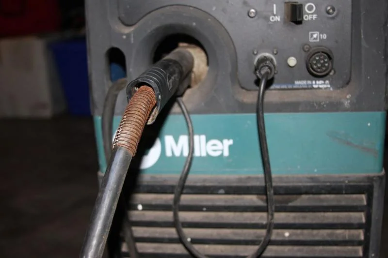

Here are a could of photos.
couple more
Congrats dude. How much did you give for it?
That saved you some cash coming with a tank and everything.
got the whole setup for 800 and he delived it from 45 minutes away. :) pretty happy. Now I want to see how she welds. I need to add a larger breaker in my garage. I had a 50amp however the manual says they recommend a 70amp so I will be doing some additional wiring.
Congrats on the welder. Just make sure the cylinder is customer owned or it will get confiscated when you take in for a re-fill.
50 amp breaker is fine for 230v input power. The manual says it will draw 44 amps at rated output (250 amps, 40% duty or 200 amps at 60% duty cycle). I doubt you're ever going to exceed the duty cycle so you really don't need the 70 amp breaker.
