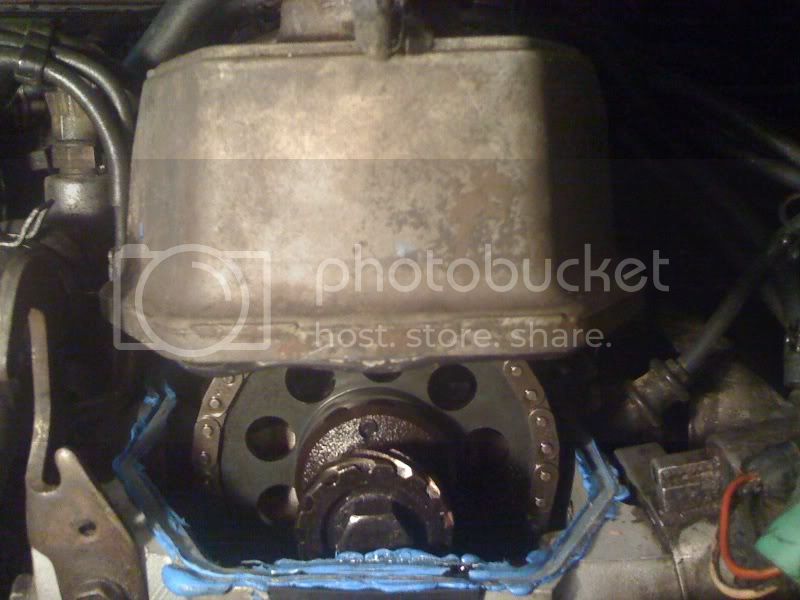

So I popped thee valve cover and here is what I see when the engine is at TDC on the compression stroke:
Is that about the right spot?
That looks correct to me......if the cam/crank timing is off too much the valve will contact the piston.
