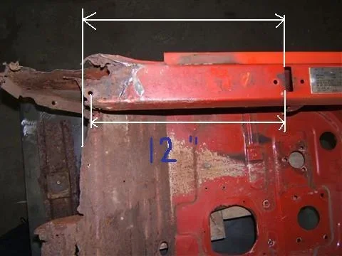

Finally got most of the work done on the frame of my 75 FJ40 and now I'm off to the cowl. Only repair that needs to be done is where a tub would bolt on to the cowl. The bracket bolting the cowl to the frame on the driver side is completly gone and the one on the passenger side is pretty ruff.
driver side - view from underneath
passenger side - view from underneath

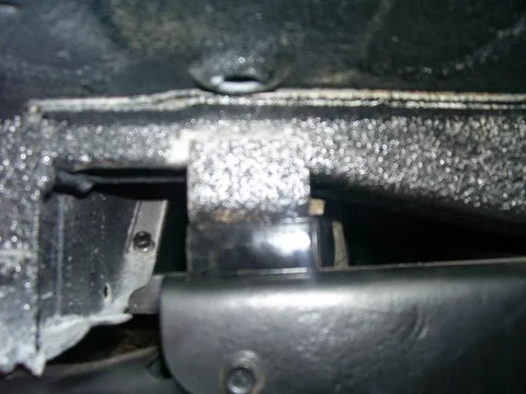

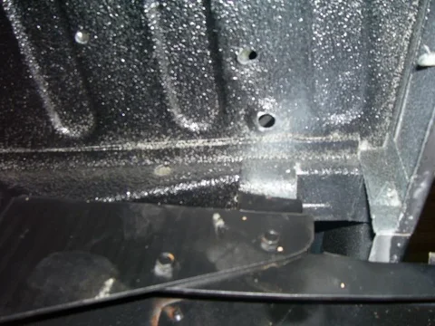

What I'm hoping to get is similar pictures of a tub in good shape so that I at least have a visual reference when doing the repairs.
Also if someone could take a few measurments (see pics below) of the bottom of the door stops both drive and passenger side to the bottom of the post and to the center of the bolt holding the cowl and the tub together, this would make this repair a little easier.
passenger side
driver side

dargreg, thanks for the pics. Would you have a close up shot of the driver side bracket (similar to the one you have of the passenger side above)?
If anybody out there has more pics, it would be greatly appreciated.

Well i promised pics and I have some of under the tub but they are worthless because of the undercoating so I really dont think they will help but if you want them anyway pm me your email and I will send away...... I did take the measurement to the center of the bolt to the bottom of the oblong opening and it is exactly 12" and I dont know on the other measurement because it is not clear to me what you are after but if I put my tape against the bottom of the floor it is 14" exactly to the bottom of the oblong hole.... I have a bit of undercoating though on the floor so it is probably actually 14 1/16" to be exact. I did attach some pics of the side that you requested though

dargreg, thanks for the extra pic. I'm sort of thinking along the same line of using some tubing the make the new supports.
4x4, thanks for the pics and dimensions. The second dimension i was looking for was to the bottom of the post (where the post meets the floor). For you explanation I think the 14" dim was what I was looking for.
