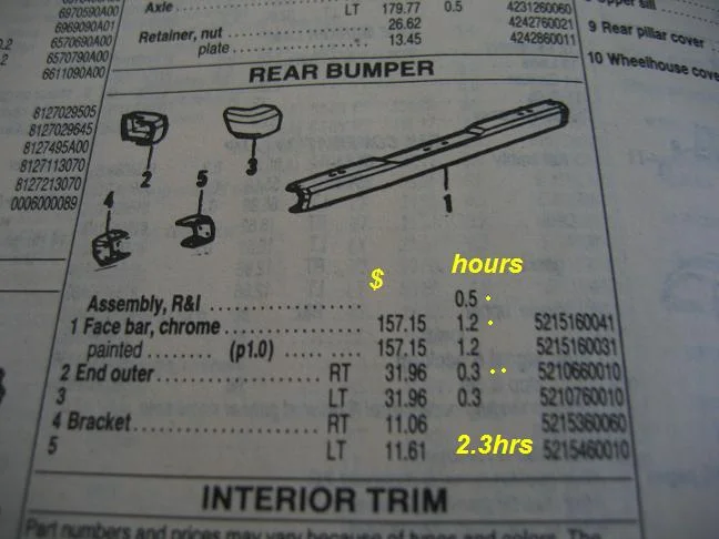

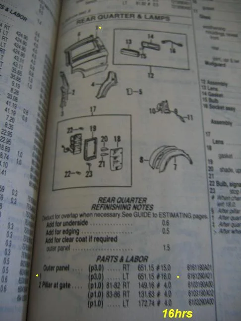

these are out of a import car crash estimating guide from 1986.. so the part prices are way off..
they show how a shop estimates repairing. The pic showing replacing that rear panel is extreme.. good luck finding a new panel, and that would be EXTREME overkill to do that repair for the damage on your cruiser.
