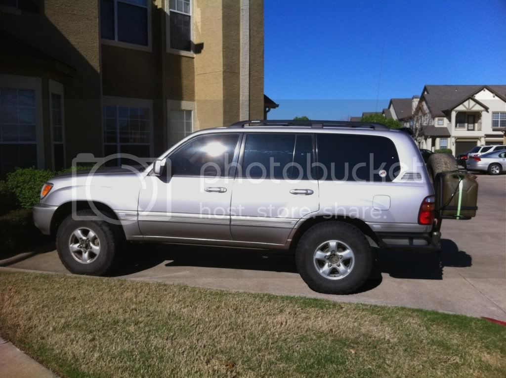

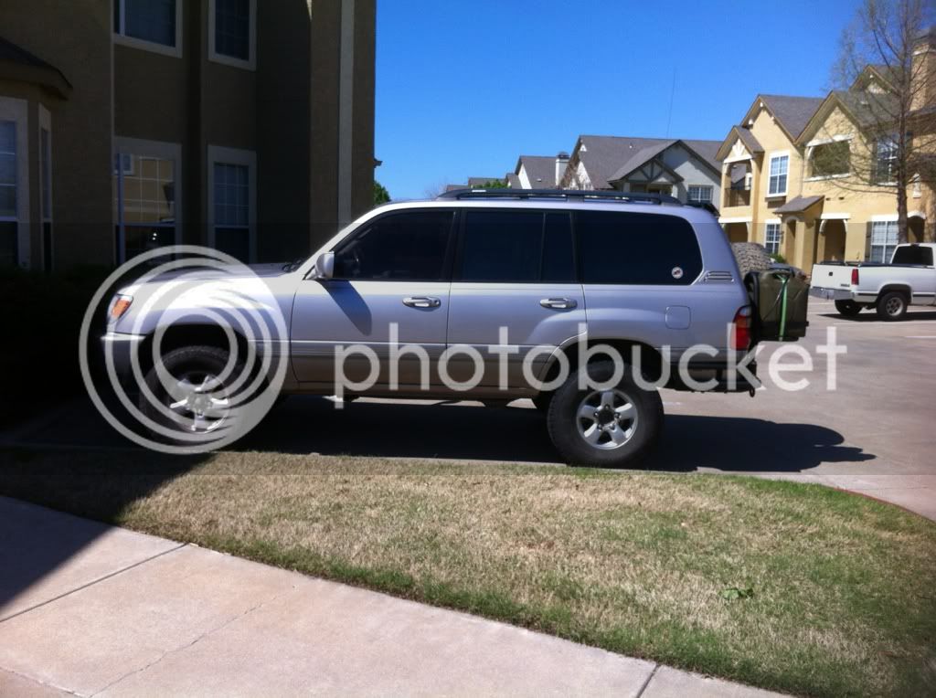

What about the progressive rate 866's? I have 863's. They are about the same rate as the slee's just a little taller.
863's
Stock w/ 30mm spacer
