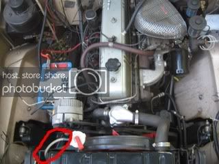

It leaks when the engine is turned off, and I don't think it leaks when it is running. when it started leaking, i opened up the hood and tried to see where it was coming from...but I couldn't see anything. I think it's coming from the radiator but i'm not positive. The problem is, I don't know where all the stuff is that you mentioned. Sorry guys...this is my first car and i'm only 17 yrs old. This is going to be a huge learning experience.
When we were on the highway driving back, the temp was just below 180.
Sounds like you dont have an over flow.
Post some good pics of the engine bay. Also start it, let it warm up, and shut it off and se where the coolant comes from.

Looks like you have no over flow resevoir on the rad. That would be the source of the "leak"

Eric you scored a pretty damn nice cruiser that has had a lot of work done to it! From the pics I can see you have the following.
F motor with possibly a Weber 38 carb with washable air cleaner.
GM Saginaw Power steering conversion.
GM Alternator conversion, 1 wire unit maybe? I could be wrong. 12SI High output?
Disc Brake conversion. Probably mini/60 series rotors and calipers up front and GM's in the rear.
High Steer setup possibly from 4x4 Labs. Drool!
Anti-wrap bar on the rear axle
Double Cardin rear drive shaft.
You seem to be missing the front drive shaft. Did one come with the truck?
Overall a very nice setup!!!!
Now here's what I want you to do. In the pic below you'll see a tube circled in red. Follow that to where it ends. Is your leak coming from there?
I do think thats where the leak is coming from. I will look into getting that bottle.

An overflow bottle can be about as simple or difficult as you want it to be. All it is basically is a container that should hold probably about at least a pint to a quart (or more) of fluid and you connect it to the overflow hose coming off the nipple on your radiator filler neck. This hose should either connect to the bottom of the bottle or if it goes in the top it should extend all the way to the bottom. The purpose is to catch the coolant escaping the radiator when it overflows, and at the same time it will draw some of the coolant back in if it needs it (that's why the hose must extend to the bottom of the bottle). I've seen guys use something as simple as a litre water bottle with a hose stuck in it, or something as elaborate as a polished billet cylinder. And you are not looking to seal it up tight, the bottle needs to be able to breathe. If I were you I'd grab a bottle of water (or beer:D), drink it, and stick that hose in it (all the way to the bottom) and see if that solves the problem. Also, the bottle should be lower than the top of the radiator. Set it wherever it will stay put, or wire tie it, or whatever works. Hope this makes sense.
