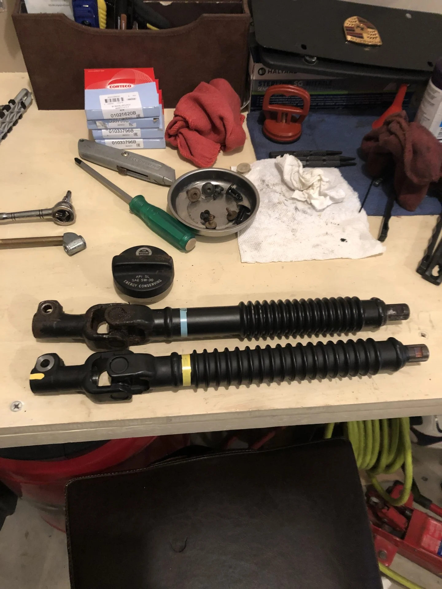

I decided to take a chance and I replaced the intermediate steering shaft. This fixed my problem. There was a definite difference in the articulation of the U joint.
Total pain in the but job to do though. Very hard to get it off the steering rack. Only problem now is that my steering pump is off about a half a turn. I really tried for that not to happen but it still did.
I’m thinking about just taking of the wheel and putting it to the new center but not sure if that’s a good idea. Don’t feel like taking the shaft off again but I’ll do it if i have to. By the way I found that oil cap deep down around that area. When The car was under warranty I used to take it to the dealer for oil changes. I guess they lost the cap during one of them.
Went back in for second try this morning got it almost straight now still off slightly to the left instead of way off to the right.
I’m thinking now to just take it in for alignment it was due for that anyways. Other option would be to move the steering wheel over one or two spots.
Anyways hard steering is fixed.
