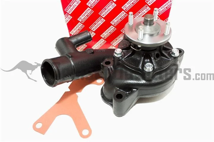

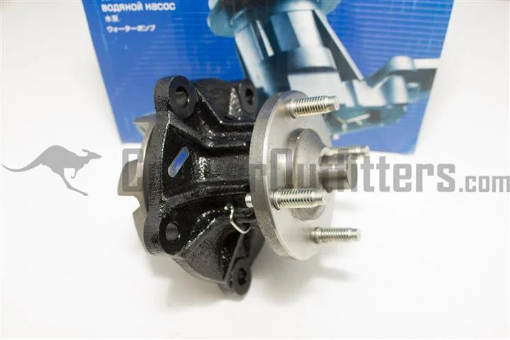

Part# EGW69015 (Cover/Rotor Assembly, 2H/12HT Diesel Applications, AISIN) $87.50
Part# EGW69037 (2H/12HT Diesel Applications, OEM Toyota) $230.50
