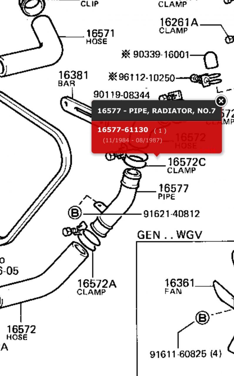

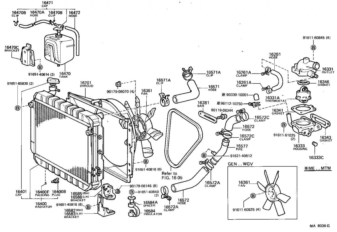

It might be PN: 16577-61130
And it might still be available new.
See drawing if it looks similar.
Google that PN.

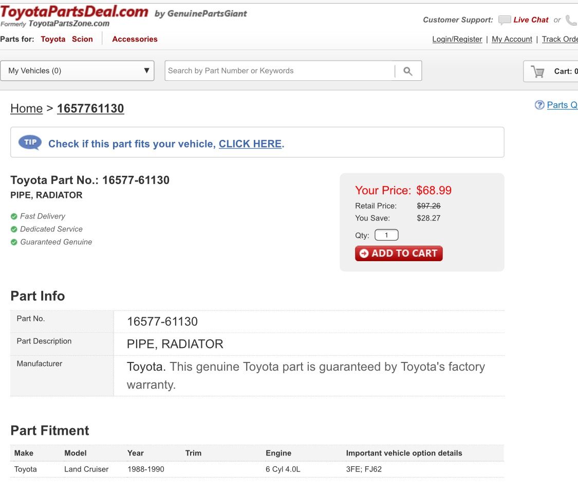

Yeah that's the pipe that you listed in the diagram but the problem I'm having is every time I search for it I find a pipe that looks nothing like mine. I have a high pressure hose company located near me that makes custom hoses and was wondering if you guys reckon I could just get them to make a hose that would replace the 2 hoses and pipe with just one big hose?
probally you could...but would it flex properly and work. What does your toyota dealer say?
So finally called the dealer and am feeling like a bit of an idiot now but they can order it, only downside is it's a 3 week wait and they want $175 for the pipe which seems pretty steep but I guess I don't really have a choice. Thanks for all the help
