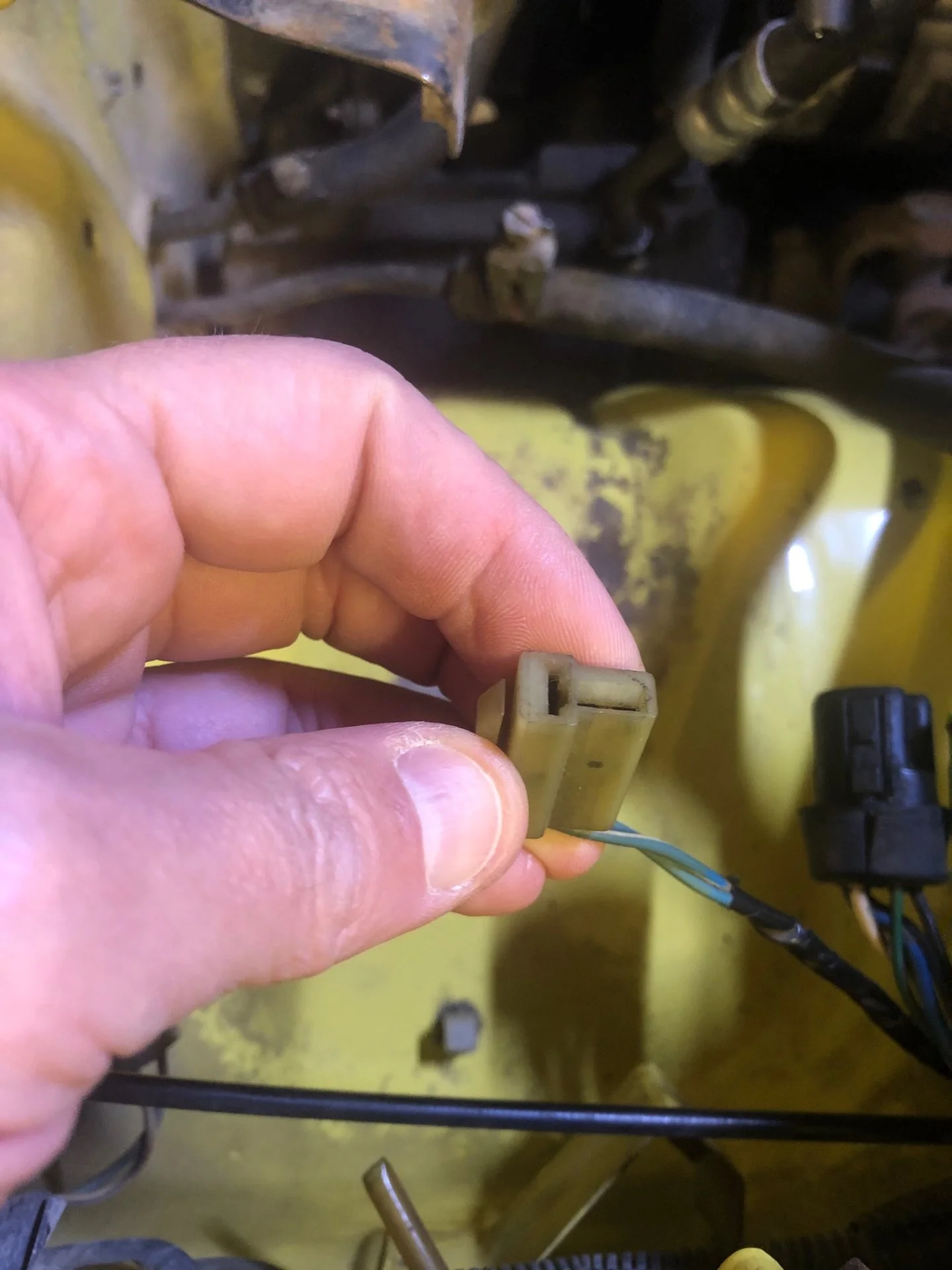

- using my voltmeter I connected to the terminal connector that plugs into the pump and when I push the washer button, I do not see any voltage on the voltmeter (see below connector pic)

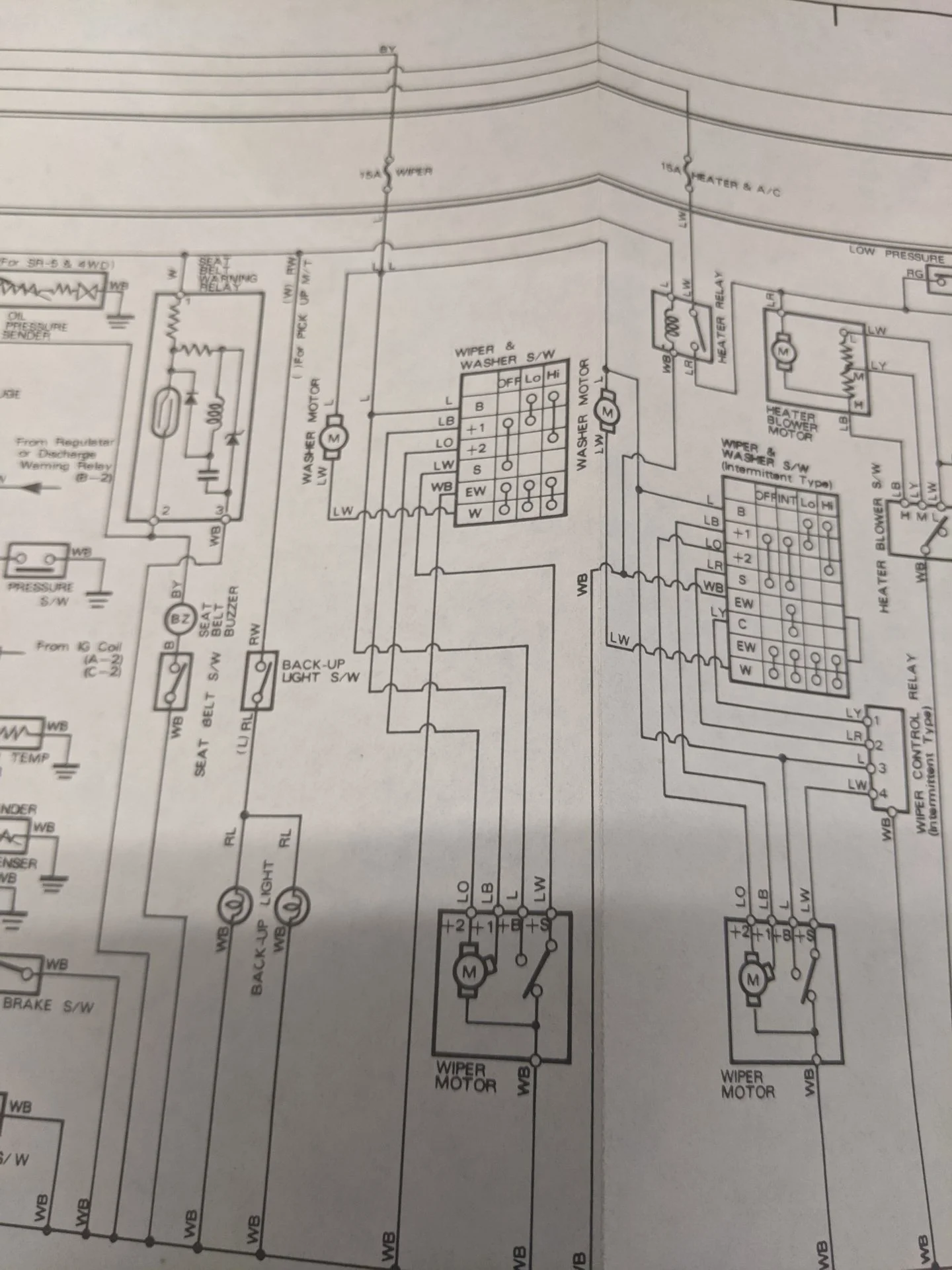

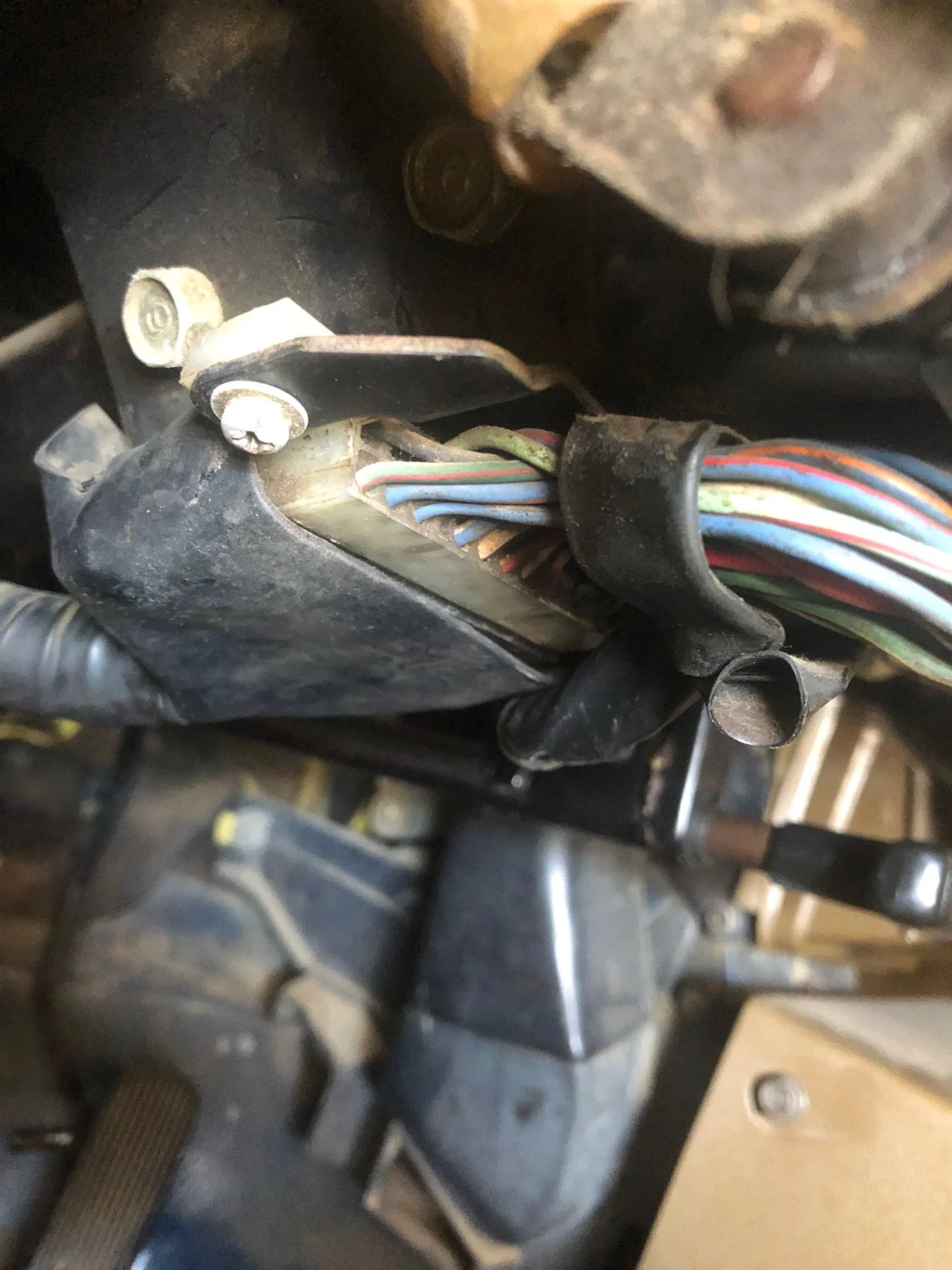

I'm assuming my next step is to test the switch, but here is where I get little lost and need some guidance. Attached is a pic of the FSM and steering column. It looks like I need to unplug the wiring connector on the steering column and then connect my multimeter (on continuity setting) across pins EW and W and then press the washer button. If I get continuity, then my switch is good? If no continuity at switch, is it possible to take it apart and clean? If there is continuity, what's next? Thanks.
You'll have to dumb it down for me gnob. I see that same diagram in the FSM. All my tests have been with the key in the on position. Not sure if this matters, but the washer pump is not the original and is just a universal pump/washer tank.
There should be 12v on the blue wire at the pump plug.
The blue/white is going to ground through the stalk switch
Ok, with key on and voltmeter connected to negative terminal of battery and blue wire on pump plug I am getting 10.4V. Seems like that should be showing 12V?
The stalk works as the ground path for all the functions, wiper as well as washer. You say the wipers work in all functions so likely the ground is good. So yes, test for continuity between W and EW. If you have continuity, switch is good.

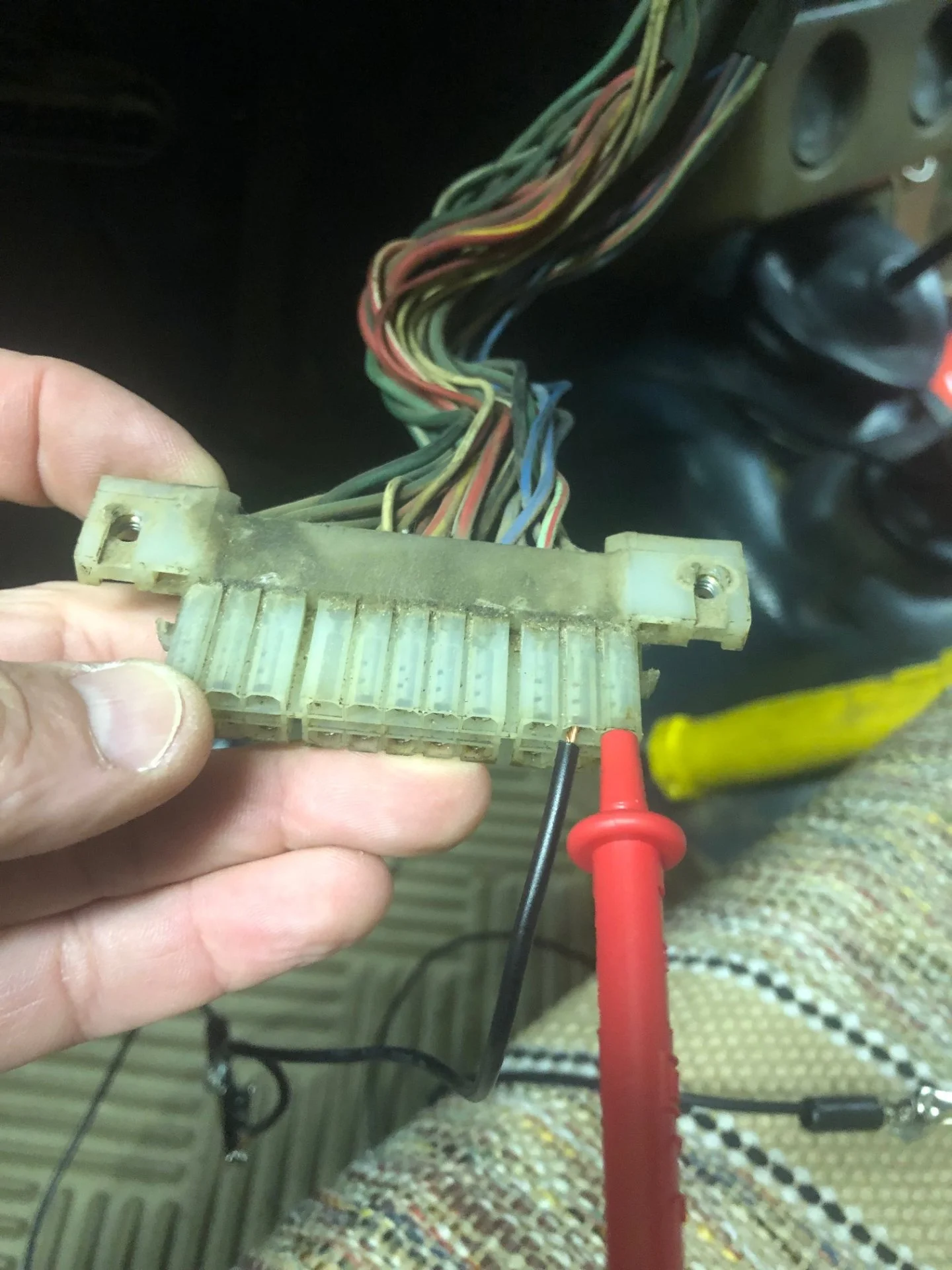

Well, good news and bad. Good news is that I've diagnosed where the problem is. Bad news is that it is the switch. I tested continuity from the wiring harness (see pic) back to the switch and I have NO continuity when the button is pressed. I then tested continuity from the wiring harness (ground side) back to the washer motor connector and I have continuity there. I tried spraying liberal amounts of contact cleaner in the wiper stalk, but still not working. I really wish I knew how to take this thing apart because I REALLY don't want to destroy it in the process. I would imagine these aren't easy to come by.
