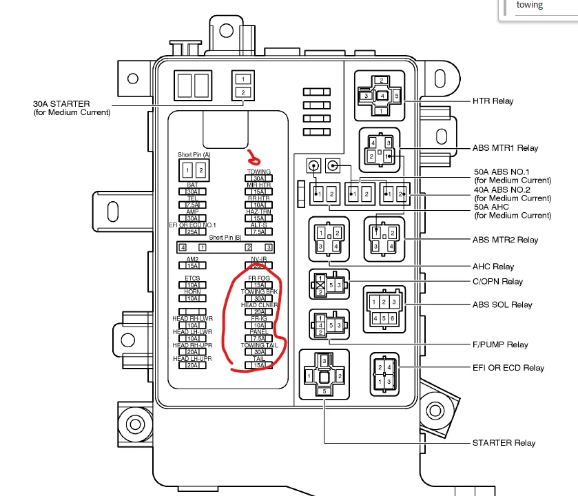

if you have the owners manual. Look up tail light, stop light, towing, towing relay, gauges, for example if the VSC fuse goes bad the ABS light will come on. Also, how about your battery, All connections tight? While it could be something unrelated. I am focusing on the fact that you were towing. Can you ask someone to help check your brake lights, tail lights, blinkers, hazard lights, include the same on your trailer. There are several 30amp fuses that relate to towing.
There is another fuse/relay panel in the engine compartment.

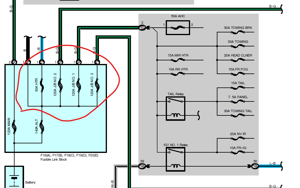

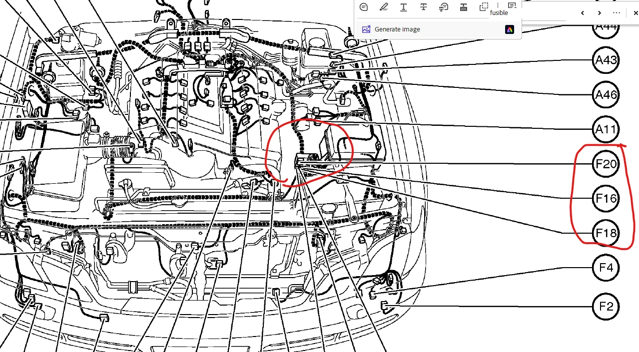

The attached wiring manual covers to 2007. Also, disconnect the trailer harness to see if anything changes.

All fuses confirmed good unless one of the large square relay ones might have an issue. Not sure how I would know about those from visual inspection. I do find. 10a that I replaced in the wrong “open” spot so the limp mode is fixed. Trying get a mobile mechanic by here later today. I’m outside Brevard, NC if anyone know of a shop to suggest

Just finished checking all fuses in the 3 locations and no issues found unless one of the large relay ones has a problem I cannot see. Not sure what those look like if the go out
My guess is a fusible link in the engine compartment.
Fusible link block. Contains a fusible wire. Acts just like a fuse. Fusible wire size is usually 2 wire sizes smaller than the source

The big fuses with the clear end, a blown fuse would be smokey looking. Or difficult to see inside.
The fusible link may look intact. You would need to feel for bumps or crunchy bits or discoloration, misshapen (sp) wire
