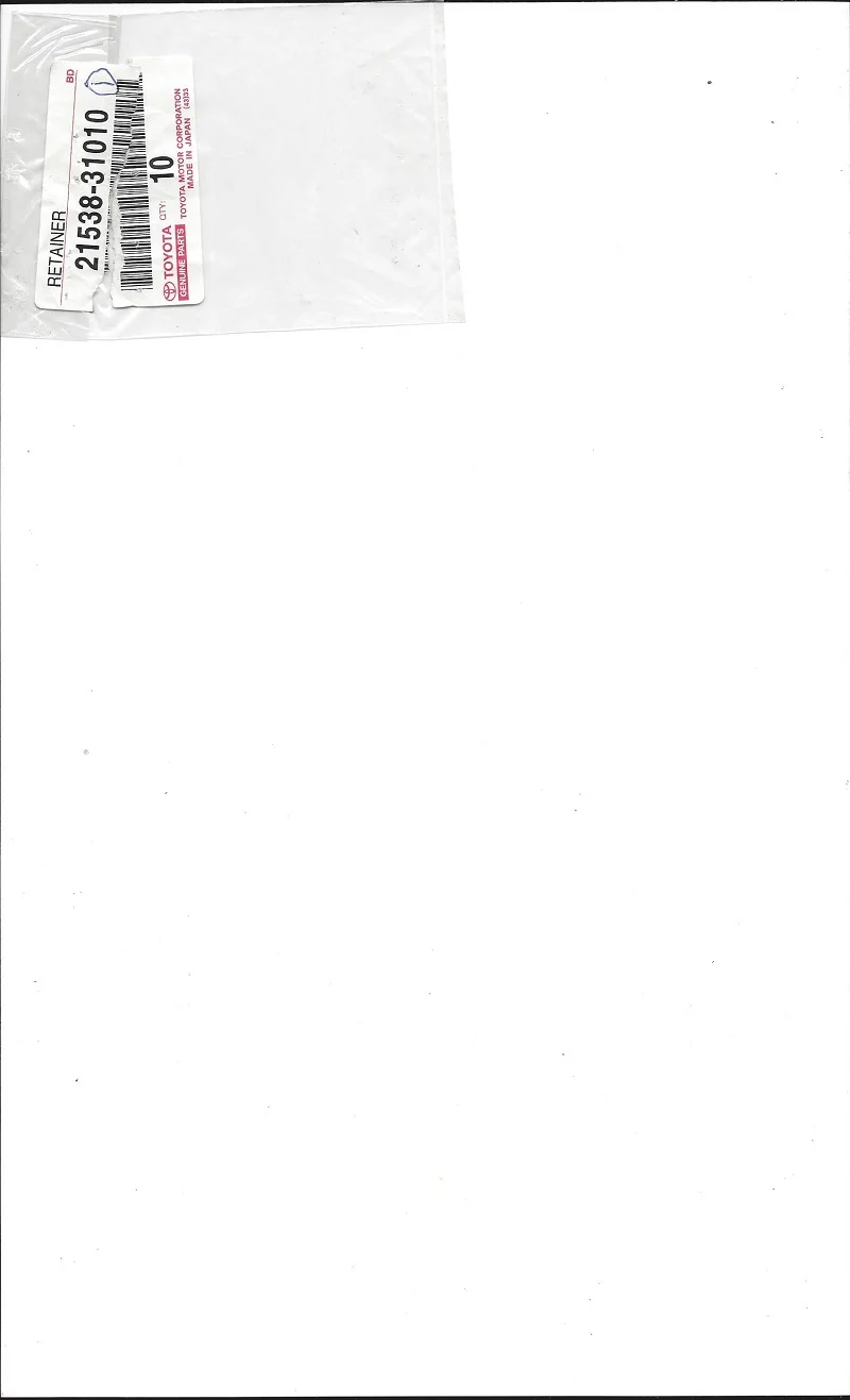

Think Pinhead's vid shows the Aisan carb rebuild kit from SMP motor products(that's the one I used)-had all the gaskets needed-even the aux pump one(3 hole)-what you will not get is the accel pump check ball retainer clip--if the carb has been sitting for yrs, that little clip will be nothing more that rust flakes--I found them still available from Toyota back when I rebuilt my carb(I bought all ten that they had-used one saved two, and gave away the rest to mud folks)
