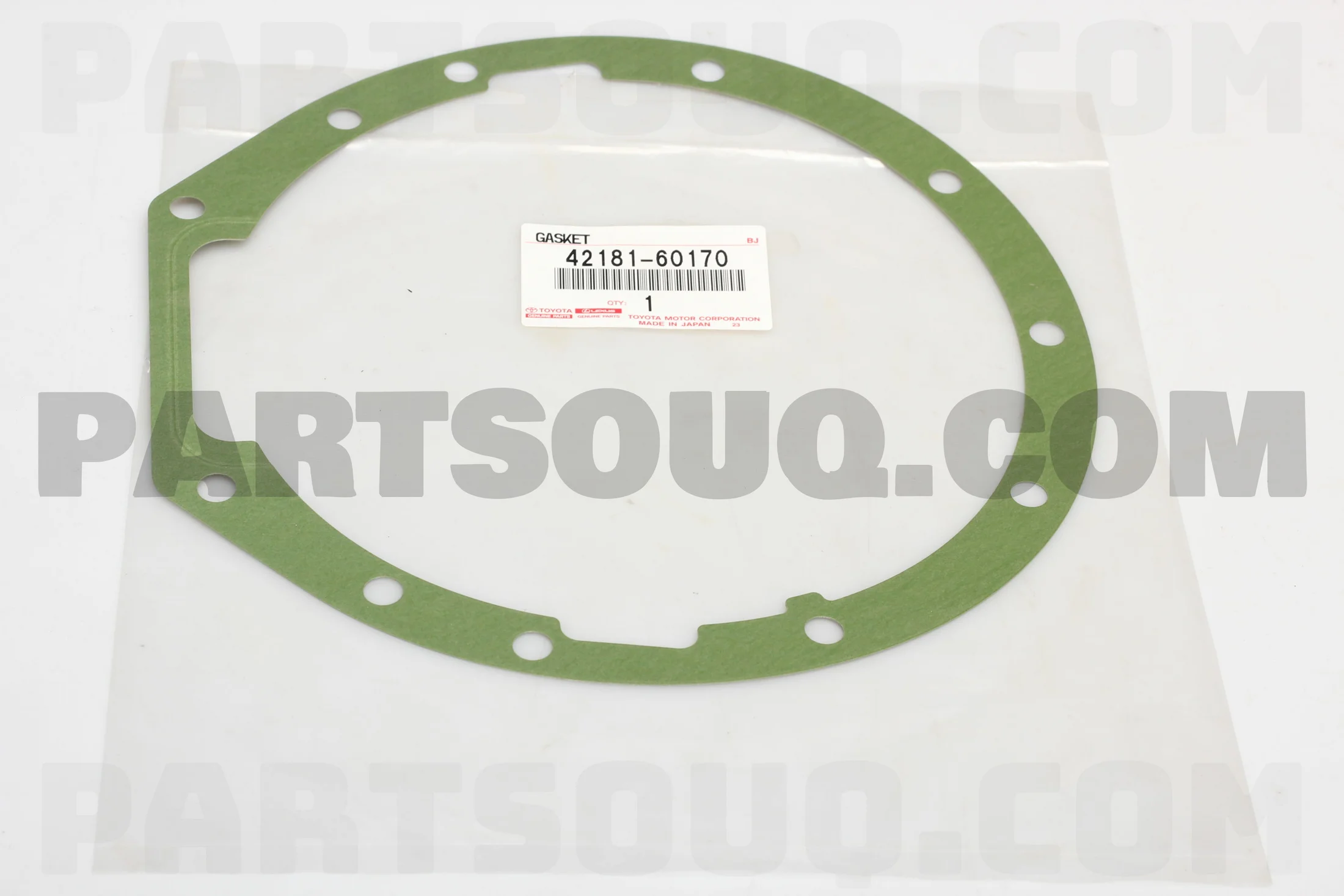

FWIW, FIPG is not a gasket, it's gasket compound (gasket in a tube). What is supposed to be in there is this:
As Mark wrote, you'll have to pull the driveshafts out of the differential in order to replace the gasket.
If, however, whoever installed your lockers instead put sealant on the face and called it a gasket I would (in no specific order)
a) hunt them down, tie them to a stake in the ground over an ant hill and pour honey on them, and
b) drain the differential gear oil, clean the surfaces as best you can with solvent (kerosene, etc) and slather more FIPG on the faces.
You might be able to get a smidge of clearance between the two faces by loosening the bolts, but I wouldn't push it.
This is doing the right thing the wrong way.
If it doesn't work, you'll only be out the work you put in and the gear oil you drained out (unless you reuse it. This is by no means a permanent, or even good fix, but it is better than nothing, until you have time to pull the driveshafts and do the job right.
This assumes, too, that you didn't pay a shop to do the job. If you did, that's another discussion entirely.
