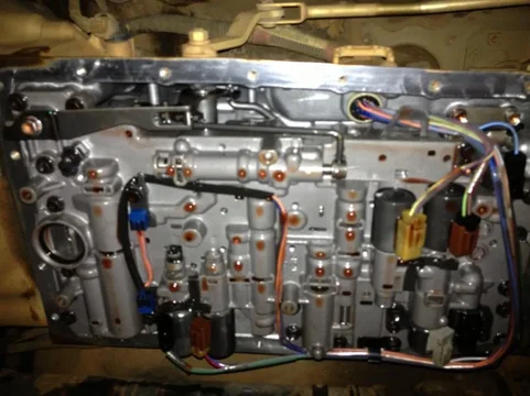

I just replaced the oil on my tranny, and after reading a fair amount on mud, where i put in 10 litres of ATF... then read on lcool.org where I found the specific service instructions about correct fluid levels... I ended up taking out about 5 litres and doing the checks at 46 to 50 degrees Celsius... And added back about a litre again...
I was also told to remove the mesh filter when the sump was off and wash that in Petrol/engine cleaner... But read that when draining the transmission naturally the oil drains out backwards through the filter and removes any dirt so no need to remove it or the sump...
But I was also cautioned by a man who knows and reconditions that tranny often, when removing that fine mesh filter that's encased in a thin 4"x8" steel casing, there is a seal or "O" ring that can get out of place
You can see the "O" ring in the hole on the Left of the pic in the middle, this photo was taken when the sump was off and the mesh filter removed so it could be cleaned & dried out in the sun.
I made sure to get another sump gasket before I did my service, but it was a little tricky putting back the mesh filter as the "O" ring or filter gasket kept moving out of place, and if that happens, I was told it can cause all sorts of problems
So I would suggest u do what I did and get your mesh filter cleaned out (easy enough job for any mechanic who knows that tranny, and get the ATF fluid levels correct, as too low and too high can be a problem
Good luck and let us know how it goes

Shane, if you have a picture with the pan removed from another angle--that could be interesting...
Many Thanks,
Greg
Those are my photos, no adjustment knob there. You need to see how much metal is in the pan of the transmission as a first step. Also some folks think a flush can stir up stuff in the pan and cause more damage.
