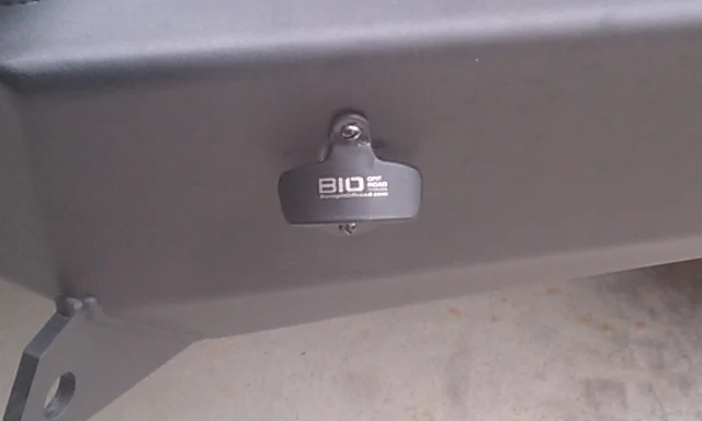

Like this
attachment.php
:flipoff2::flipoff2::flipoff2:
These are super cool, I was up at Mike's Shop yesterday picking up my new rear bumper and he said he was out of these and was having trouble finding a fabricator that would do these for a reasonable price.
So if you have one, you are lucky, might be a long wait for another run on these.

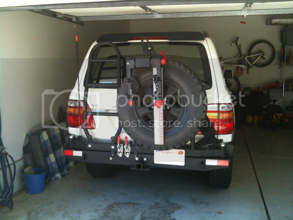

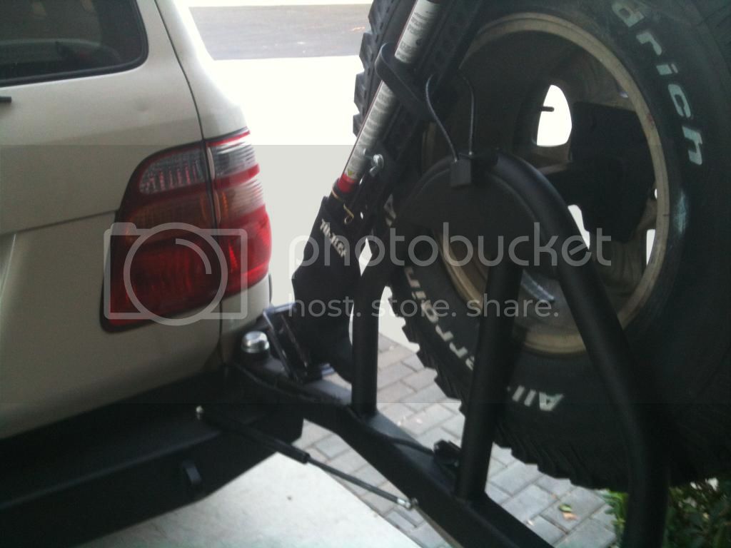

I use my antenna with a splitter for AM/FM and CB and I could never fit in my garage using the tire carrier mount, although its probably more ideal. I can still get a sub-2 SWR from the mount I had Mike do up in the second picture, with a 4' firestik. I'd advise anyone who gets this mount to have him make the mount about an inch taller for the sake of room for the coax connector.
The carrier antenna mount makes a great location to stick on gunlock through for a farm jack though. :)
This is actually a 3' pictured, which was too short to give me a low enough SWR to work.
