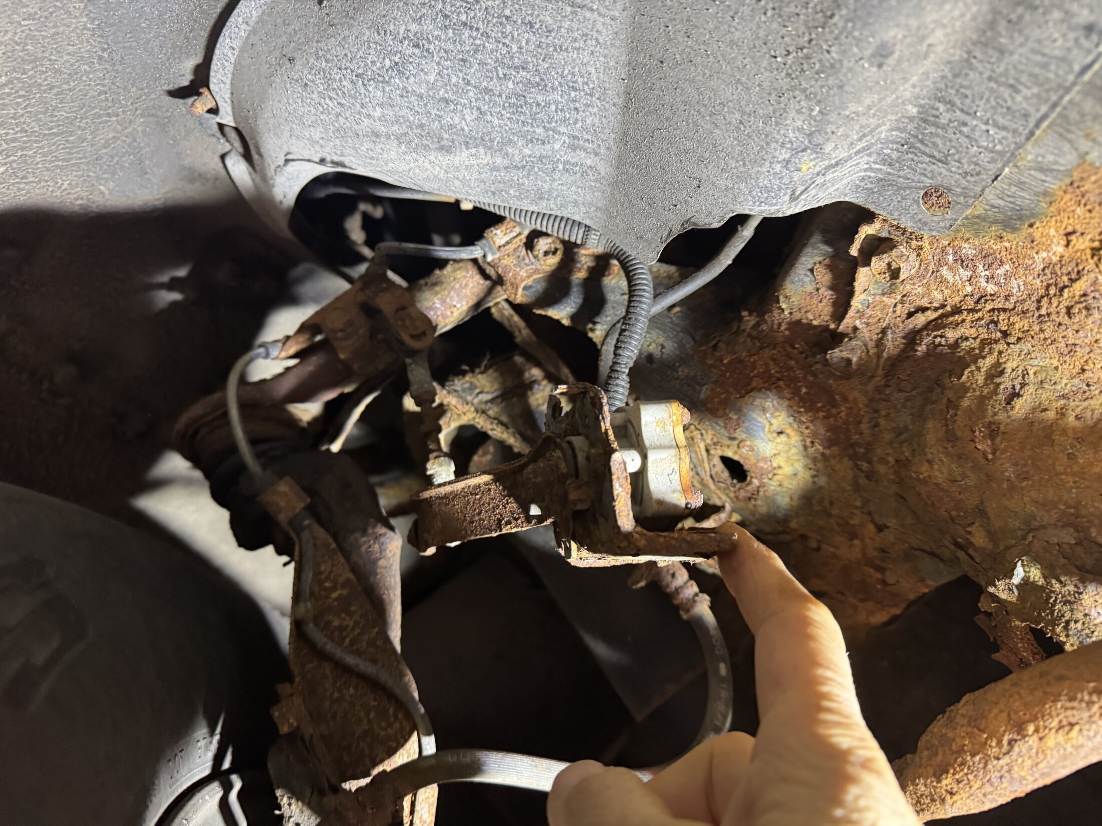

This is the Driver’s side front wheel.
Yeah, I know the rust looks horrible. I’m gonna have to replace the upper and lower control arm on both sides. Not so much that they’re rusted through although the surface rust is pretty rough. I plan on using wire brush which I’ve already started getting the big chunks off and then fluid filming. I have to replace things because some of the bolts are so rusted. I can’t get the heads to turn. I was fixing a sway bar link bolt that broke and I see this hanging here
Can anybody tell me what that is?
It has wires going to and coming out of it. It should be hooked to the frame but it appears to have rusted off of it and is hanging there.
Thank you.
2002 lx470
AHC ride height sensor.
Awesome! I thought it was some kind of sensor. I’ll let it hang then because I remove the AHC about eight years ago. Thank you so much just didn’t want it to be anything that would be dangerous not to address.
