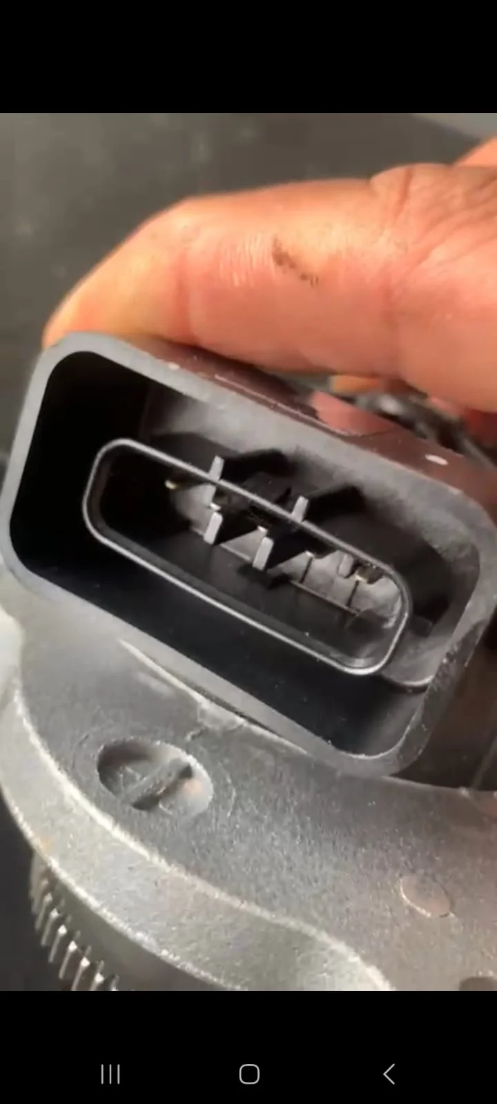

I am in Costa Rica and have a 1991 TLC 80 Series turbo diesel. The 4x4 was not disengaging because the little motor in the actuator stopped working. I was very hard to find a replacement for the 80 series. I was told the 100 series actuator (Part Number 36410-60061) would work and that the wiring could be retrofitted. However, we are having a hard time finding the pig tail for this actuator. Can anyone help me locate this 5 pin pigtail?

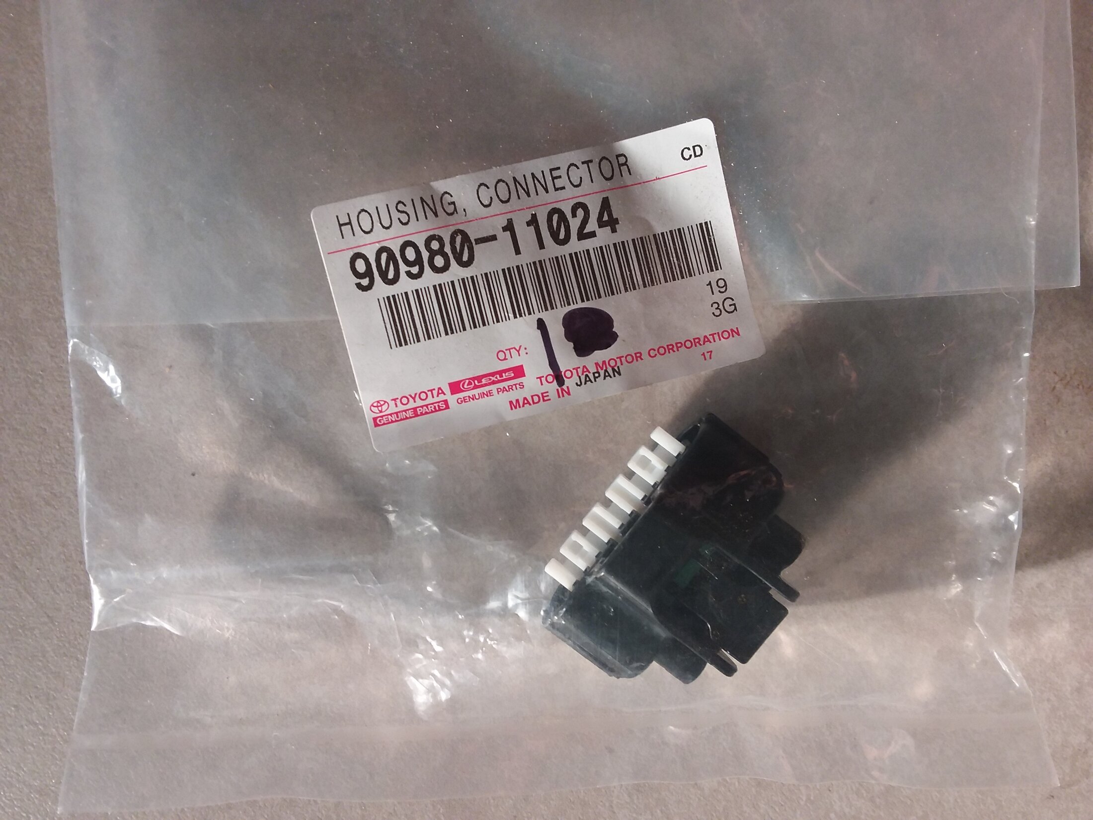

This is the harness plug for a 100 series center diff actuator. I bought it becauce the lock tab broke off on mine but I haven't installed it yet.

Thank you for the reply but that one won't work as there are two notches inside.
