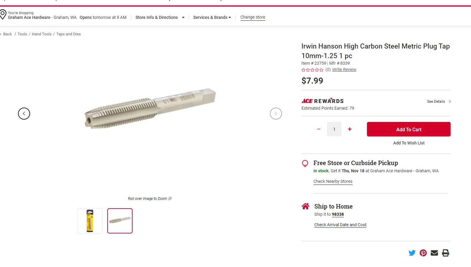

Something like this right? If I recall I had to do this on one of my 4Runner hard top bolt holes because the threads were messed up. I think I just started threading it through since the top have of the threads were good and then it corrected the remaining threads when it went in? That was 10 years ago though....
sounds like you got it
I had to do this recently. Replacement bolts from Toyota parts sites were not the right size. Make sure you buy the die though. More common to have a bolt problem. I think it’s because if your seat isn’t positioned just right the bolt threads will gall against them (as opposed to a cross threading issue or similar with the bolt hole itself). Amazon has what you need.
Happy to say the Irwin Tools 10x1.25 tap worked fine. I used the one I found locally from Ace Hardware. Took about 10 minutes and I just used a box-end wrench after hand threading it a few turns. Backed out and kept working my way down until the bolt went in smoothly and snugged right up. Thanks for the help!
