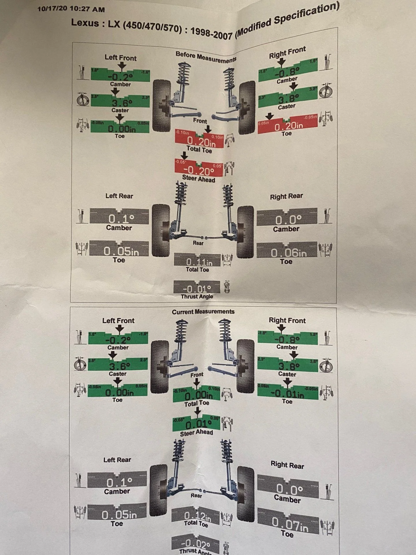

Would help if you post your alignment sheet
Thanks everyone for your input! Much appreciated. After your input, I went ahead to increase my tire pressue to 40 psi all round, I am running Michelin Defender M/S 18s. This didnt seem to help. I do not think it is the crown of the road because I've noticed on flat road and other roads if I center the steering wheel, the car will pull to the left.
So to describe the issue a bit in detail, when I straighten the direction and take my hands off the wheels, I seems the car pulls straight. The car still pulls straight when I apply slight brake pressure. The problem is that when the Steering wheel is at 0 degrees center, this causes the car to pull to the left. If I turn the steering wheel slight right about 20 degrees, this will track the car straight. So is the issue with the steering wheel? do I have to take the steering wheel off or have the shop do it? Please see pics of my 1st and 2nd alignment below if this helps.

My point above was that if the vehicle tracks straight with your hands off the wheel, (but the wheel is off center) is that it may be your steering wheel alignment. If you let go of the wheel and it pulls to the right or left still, you have something else (as detailed) going on.
Its not the alignment per say, is does not sound like the car is pulling. The steering wheel is not centered properly. If you hold the car straight while driving (do not look at the steering wheel) and it tracks straight then it's not pulling. During the alignment procedure the steering wheel must be locked at center before tie rods are adjusted. You should go back and explain that the steering wheel is off center.

Guys, really appreciate all your help and input. @abuck99 thanks for the VGRS reset TSB. I did that today and it helped quite a bit. The steering wheel now feels a lot more centered when pointing the car straight! Thanks everyone!
