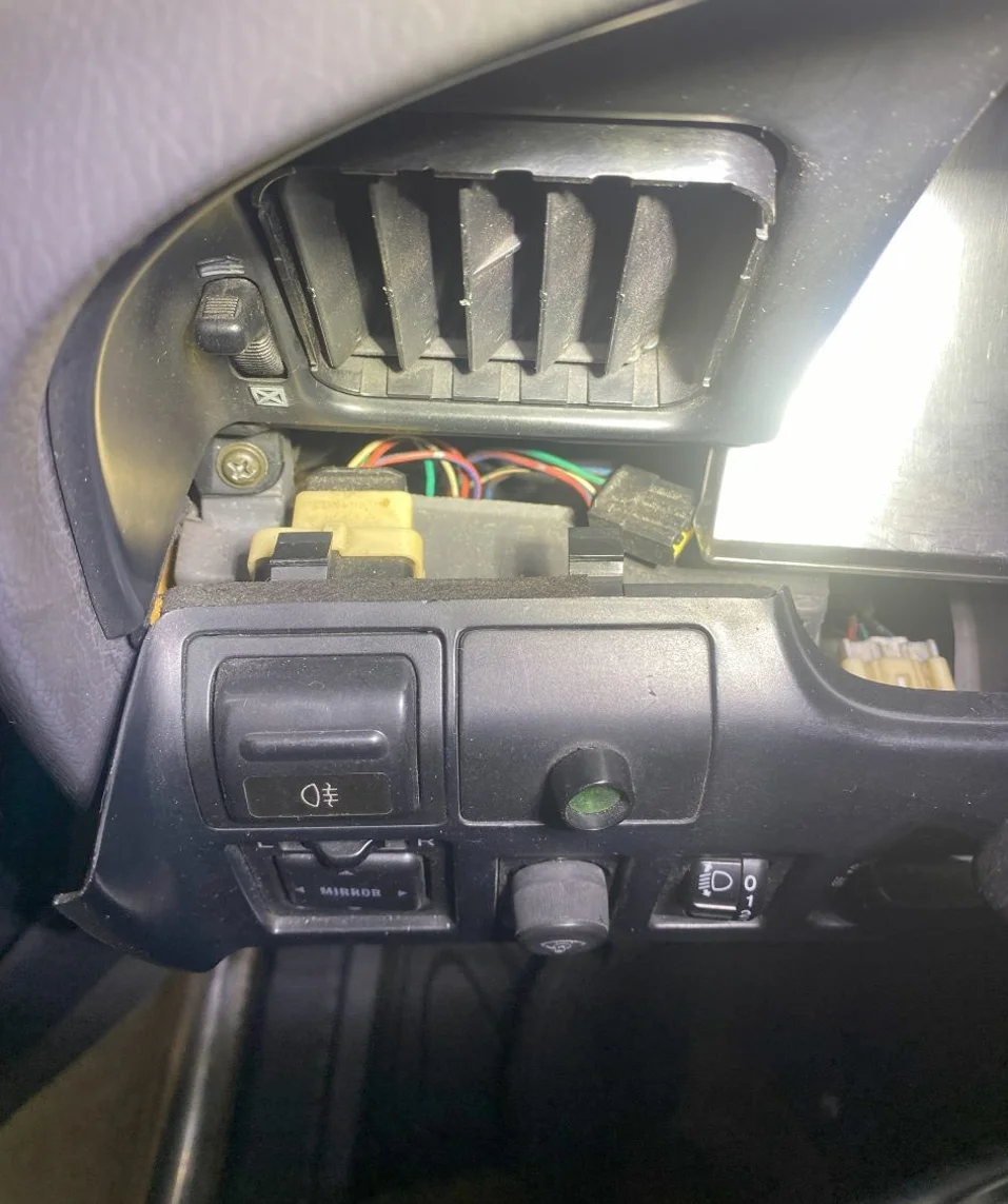

As I go through my rig and catch up on some overdue maintenance, I found a green-lit switch next to the rear fog light switch and wasn’t sure what it was for. Following some advice here, I pulled it out to trace the wiring and discovered that it's not connected to anything—there’s just an unplugged port sitting behind it.
I did some digging using my VIN and found that it might be for the headlight washer system. But I don’t see any nozzles on the headlights, so maybe it was deleted by the previous owner? Or is this port meant for something else?
Since this switch is next to the rear fog light switch, could it possibly be for the front fog lights? I honestly have no idea how to turn the front fog lights on otherwise…

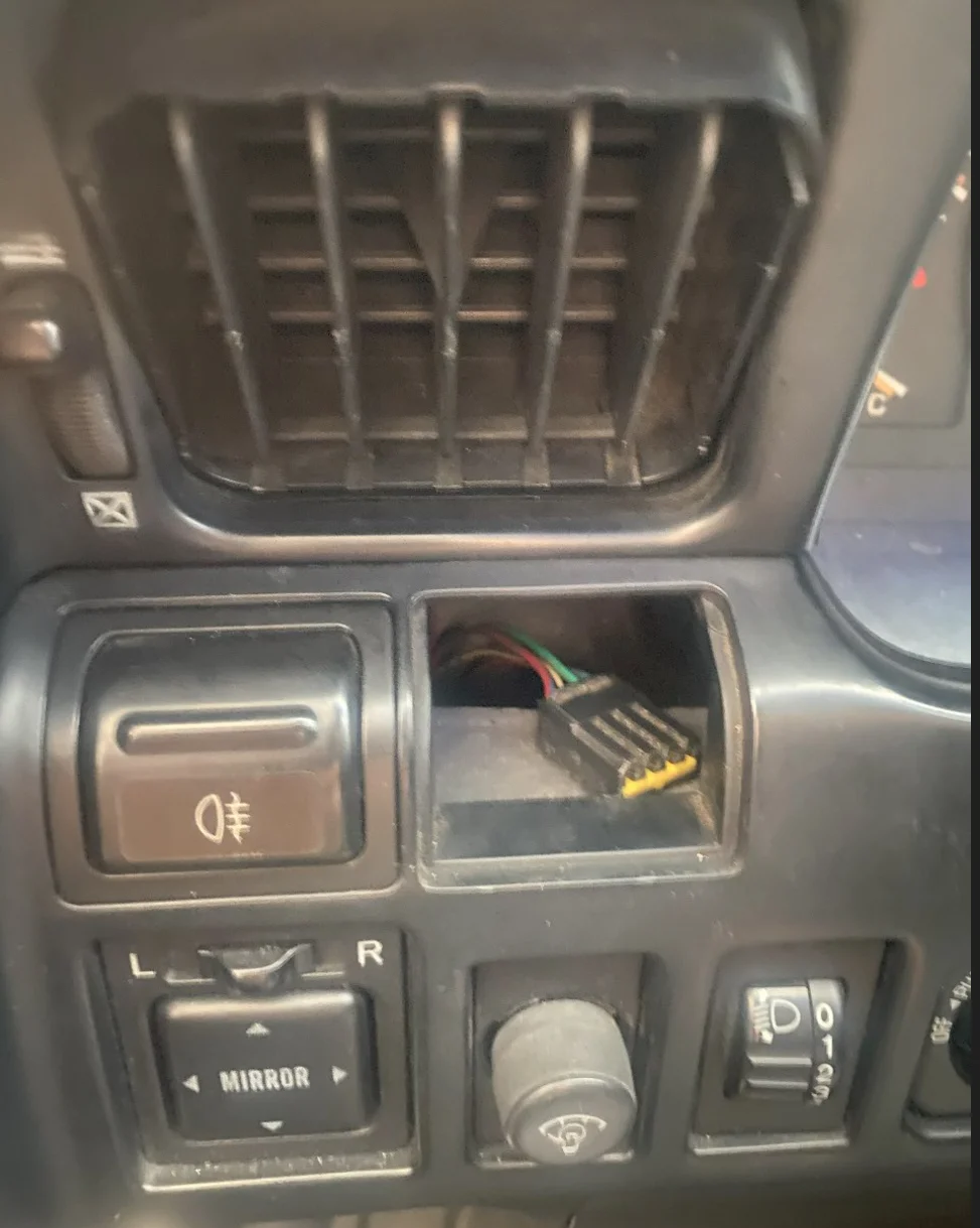

That cover is where the headlight washer switch would be found - if your vehicle had one. The connector may be for the washer switch and is just unused. The green light was likely an owner installed indicator for some 3rd party device, maybe lighting?
That is where the headlight washer switch would be found - if your vehicle had one. The green light was an owner installed indicator for some 3rd party device, maybe lighting?
The green light isn’t connected to anything, there was no wires behind the switch. I was planning to replace it with a headlight washer switch, but later realized the washer system had been removed... here is my real question... how can I turn the front fog light on...

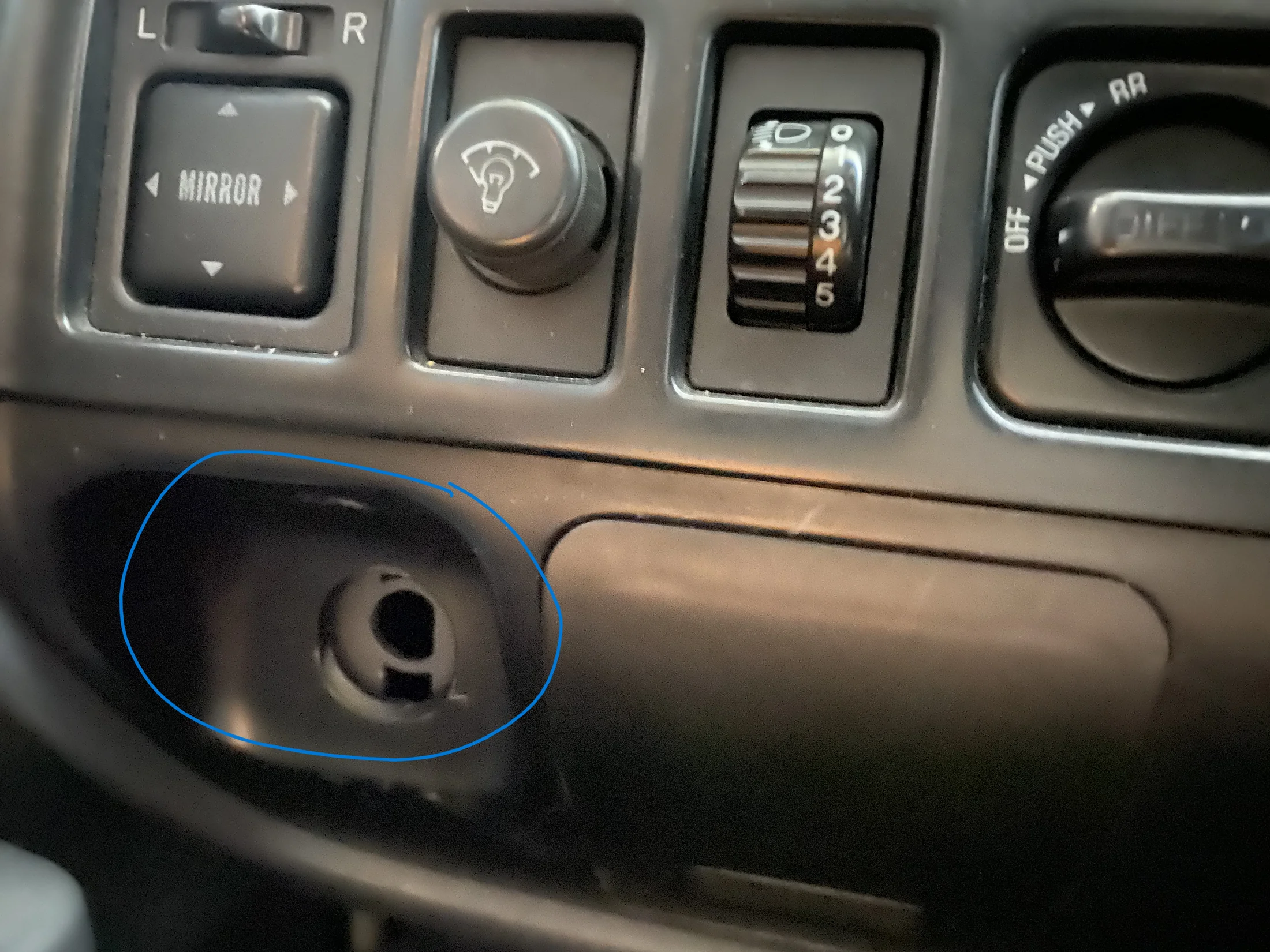

Does yours have a hole like that?
The front fog light button is the button you are describing. I have the headlight washer system and the button for that is next to the fog light switch. The hole below is for the hand throttle (can adjust idle speed in cold/cooler temps).
