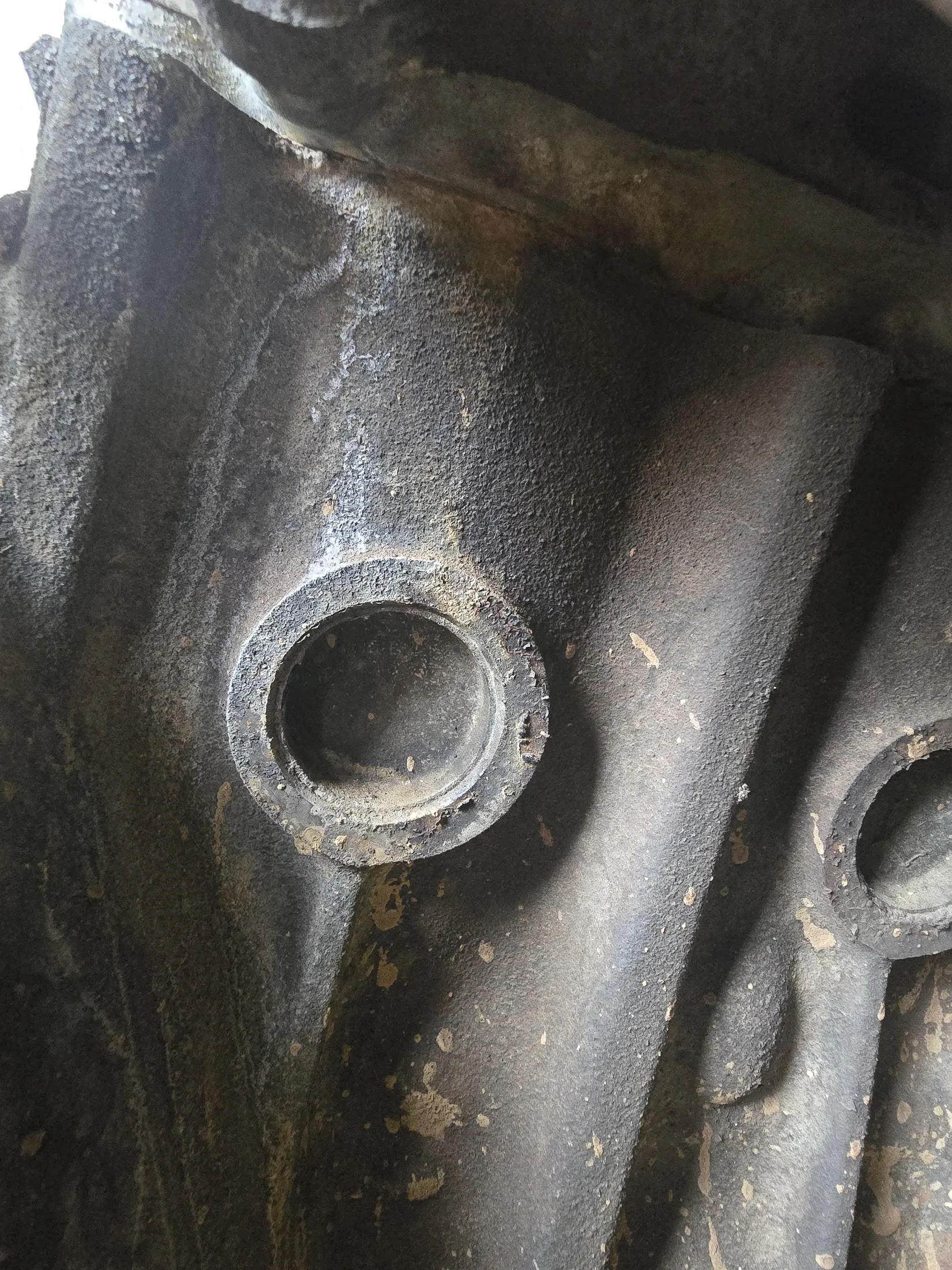

I couldn't find my coolant leak for the life of me. Headgasket blew out on cyl 3/6. If nothing else works, check under the exhaust manifold.
It never hit the ground until it got way worse one day.
In my case, looks like the PO i bought it from tossed some block seal in and I happened to be the next victim. Lol.
