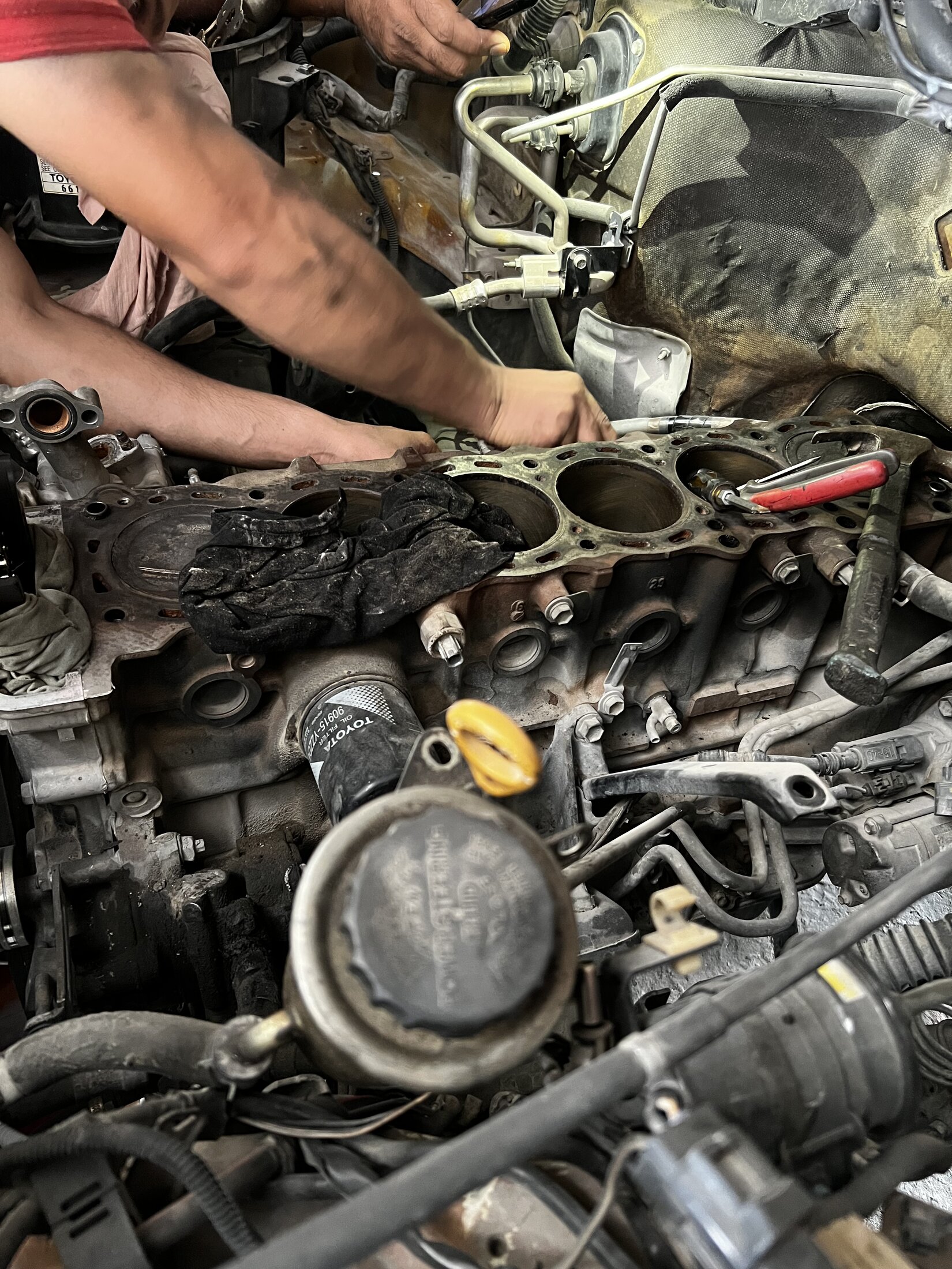

Is that a pair of pliers and screwdriver laying inside the cylinder? Aren't you worried you'll scratch the walls and lose compression?

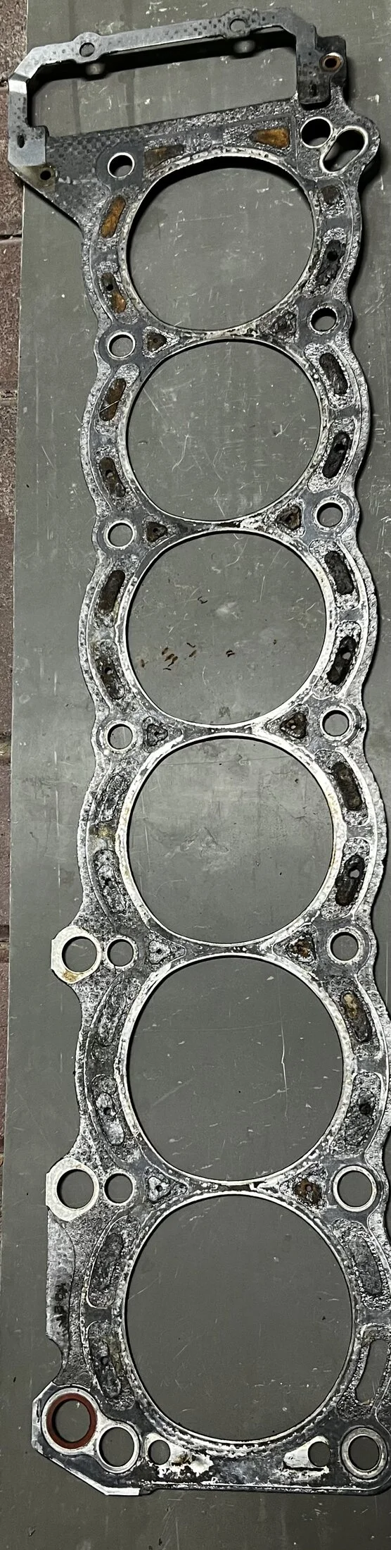

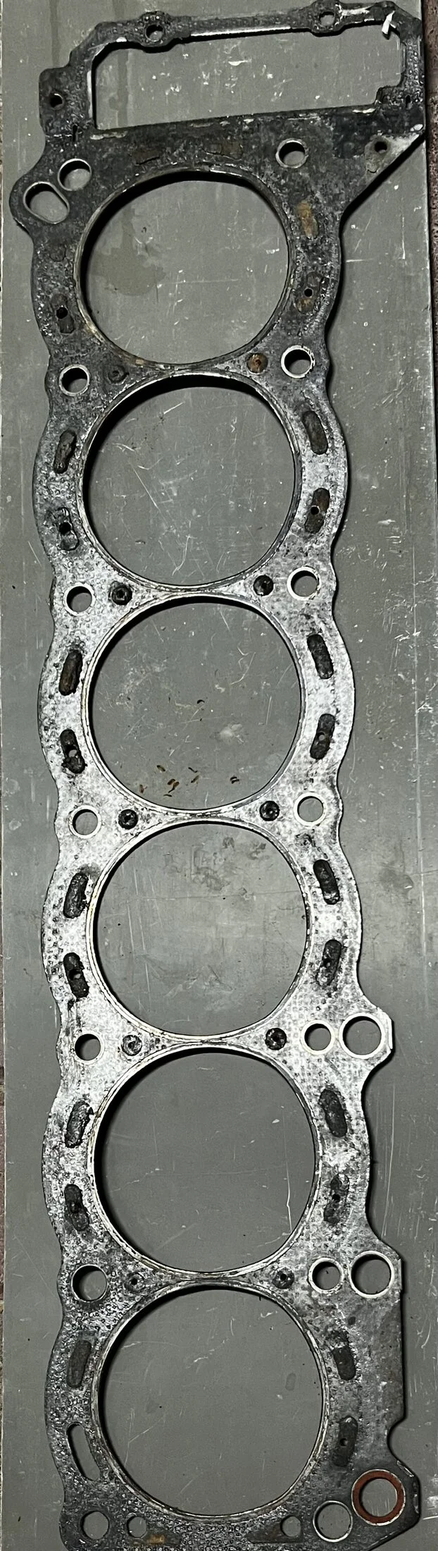

Do have pictures of the head gasket, both sides. #1 cylinder doesn't seem to be sealed in the front.
Hi here’s the pic:
And no the combustion leak down test was not done, I wasnt aware of suck tests, when I took the car to the garage they looked at the engine coolant intake hose and said there’s pressure in the engine.
I honestly didn’t notice it at the time, but the block has since been completely removed and inspected. The report came back as perfect condition for both the head and the block. So I think it is fine.

The first picture of the head gasket, number one cylinder near the timing chain between 11:00 and 12:00. Doesn't look very good can you take another picture. The engine block needs to be cleaned with a wire wheel, then you can inspect it for pitting. The wire wheel will take off any remnants of the head gasket material, it's difficult to see the pitting unless you use a high speed wire wheel. The blocks that I've come across have never been warped. If that's what they're calling good that it's not warped, you need to check again for pitting. Around the firing ring and around the water jackets. Also inside the water jackets is there excessive buildup of scale and rust?
