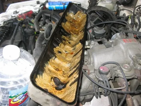

There is some sludge buildup under my valve cover, similar to this one:
