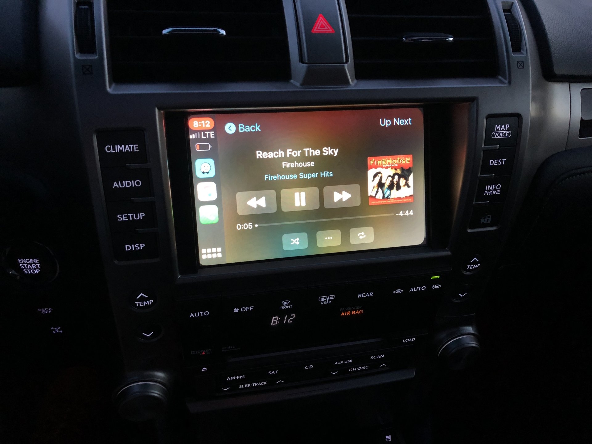

Hi everyone,
I just did a video review on my channel with my initial impressions on the Grom VLine installed on my 2017 Lexus GX 460.
Here’s the link:
I’ll also add the pros and cons here as well:
Pros:
  • Allows for Apple CarPlay and Android Auto usage
  • Android device means app installs (if you want to install apps on your Grom VLine such as Google Maps and Waze)
  • External inputs
  • Ability for “some” steering wheel controls (I talk about this in my video)
  • Ability to update itself (software and firmware) via WiFi or USB
  • Compact design
Cons:
  • Intermittent issues such as device freezing, volume setting at a certain level all of a sudden, etc... (I explain my personal experience with this in my video)
  • Price is too costly of all you want is Apple CarPlay or Android Auto usage
  • Cannot use steering wheel mounted phone buttons
Please feel free to leave your comments in the video. I hope to give an update later on how my Grom VLine usage is going.

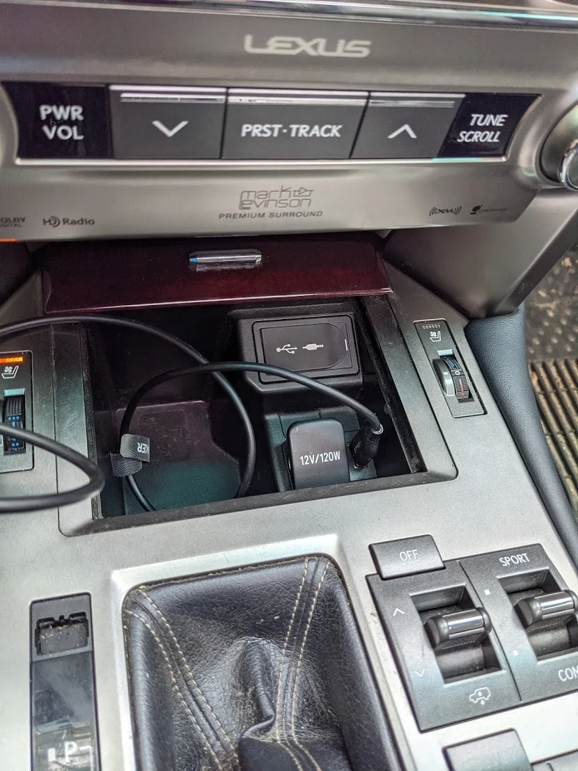

I've had mine for several months now and has been great. I didn't replace my stock 12v in the center console so I can still charge mine separate from the grom unit. To me the biggest disadvantage of the plugged in AA or carplay is the low charging speed, it seems to maintain rather than actually charge. I got a separate usb extension mount on amazon and installed I next to the 12v port so I can use my normal charger (which is why the cover doesn't sit completely flush when nothing is plugged in). I'm on android so waiting one more month for them to release wireless AA.
