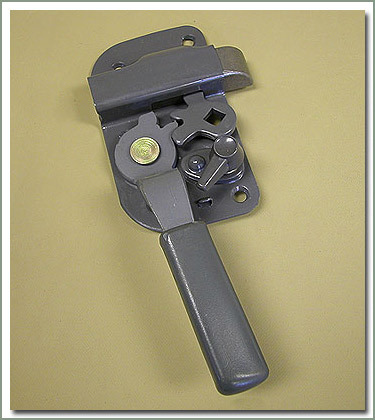

one more pick of a complete rear lock for a Troopie

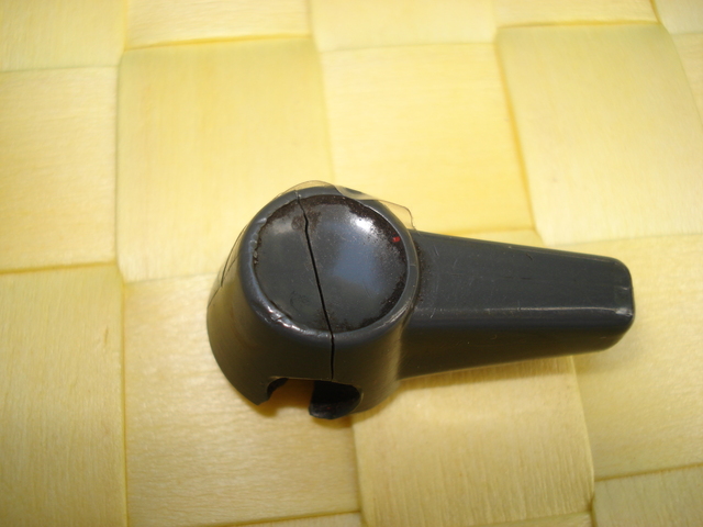

need only the little grey knob ;)
my broken knob

Sorry Peter, they didn't have the knob or the steering wheel. Just got a late model FJ45 one and the knob was also missing on the spare door I got. The funny wrecker confused a diesel with a petrol engine, so couldn't get everything I wanted either.

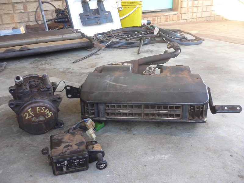

Is that here the original FJ45 aircon? Looks pretty genuine to me at least.

That aircon is Toyota - fitted by Toyota dealers once the vehicles came into the country, or as an option at purchase or later.

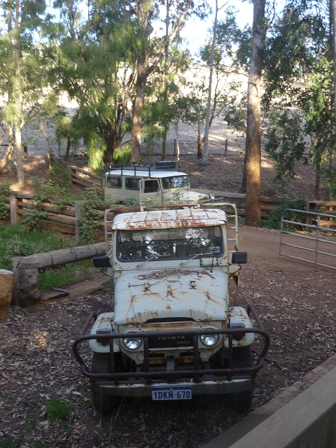

This is an old HJ45 that is still used on the very modern farm I was working on. A real rust bucket but still up and running. His little brother (my truck) is hiding behind him. ;)

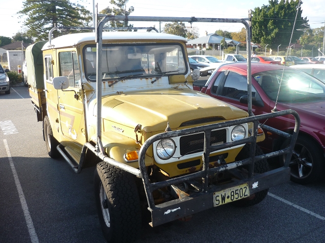

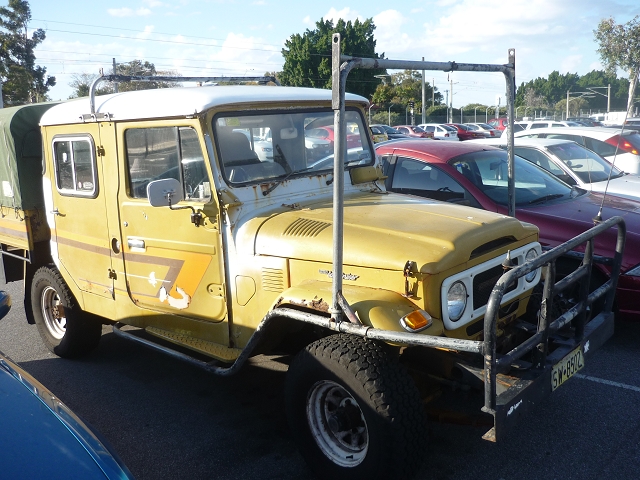

and a bit more interesting, a dual cab ute/pickup. Saw that one in Perth on a parking spot. Does it look like one of the mining vehicles that got chopped back in the days or does it look like a unique one? Unfortunately a little bit rust here and there as well and I hope the owner will target that at some point. :)
