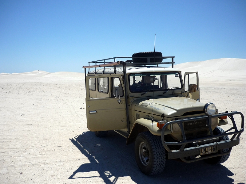

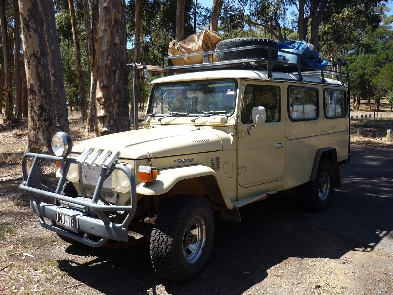

Hi there!
Have been reading here for a while and finally registered as well. I am originally from Germany but have been in Australia for almost 2 years now. Fell in love with the 40s cruisers here and own the most reliable travel companion, my '84 HJ47 Troopy. :)
The plan is to ship it in January back home to Germany and start rebuilding it a bit when it arrives in March. It will always be an expedition/travel build so I will get everything out of the rear and fit a new home made setup. Right now it has a rear bench that slides out to a double bed, storage at the right, an old but perfectly working Engel fridge and a stove. On top of the camping build it has an auxiliary fuel tank, water tank, dual battery and a solar panel for the roof rack.
My mechanical knowledge is limited but I am trying to teach myself everything I can and will hopefully learn a lot during the small rebuild. :)
Lets start with some pictures:

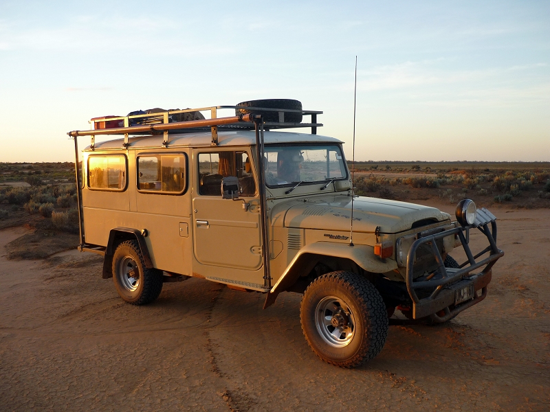

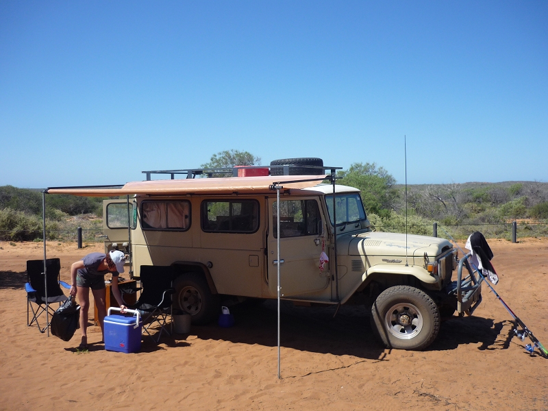

our camp

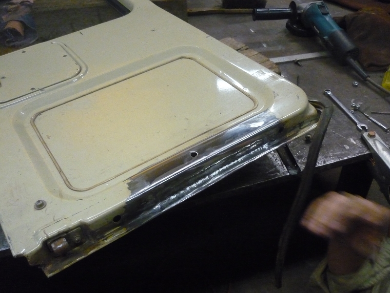

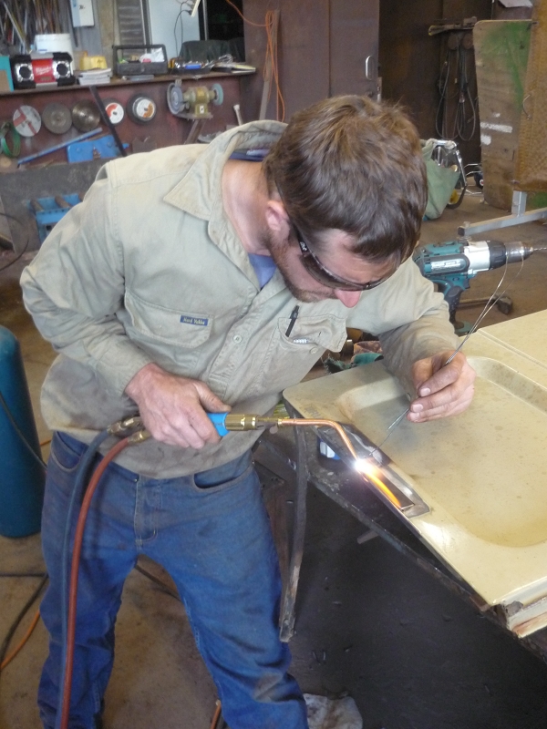

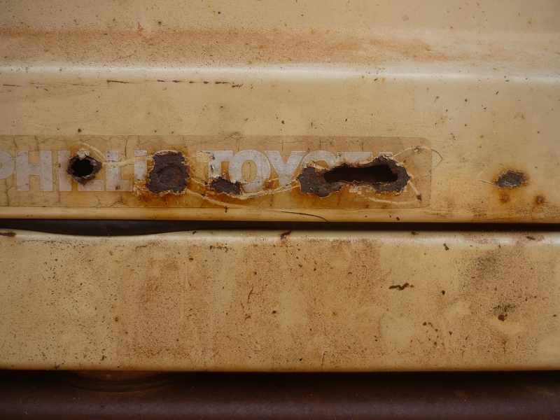

and just started with a work mate on some little rust repairs for the rear door
Further plans are to take the chassis of the frame and repair any rust I can find. There is not much but you never know where it is hiding. This weekend I will fit a Hiclone. Thats a steel part for the air intake that increases the air flow and gives you a better fuel economy. Its supposed to work best on old engines so I will give it a shot and let you know if it is any good. :)

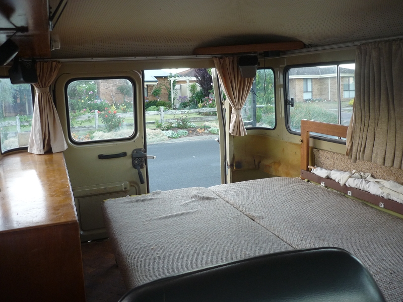

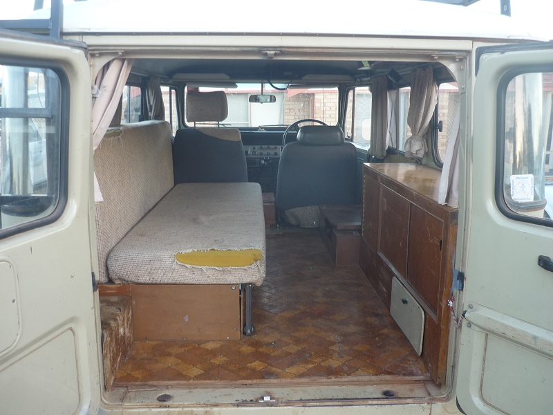

Took some quick pictures of the inside for you. The timber and the mattress are not in the best condition anymore due to the regular use. But as I wrote before, all that will be replaced mainly because I am quiet tall (~6.3 foot) and my feet are hanging way over the bed plus I can't take my drivers seat all the way back because of the fridge behind it.
The view from the back, fridge is usually behind drivers seat and 2 burner stove behind the rear left door as a little kitchen construction, might take it out of the storage and get some pictures as well if interest is there. By the way, I am not a big fan of this granny design of the floor. ;)

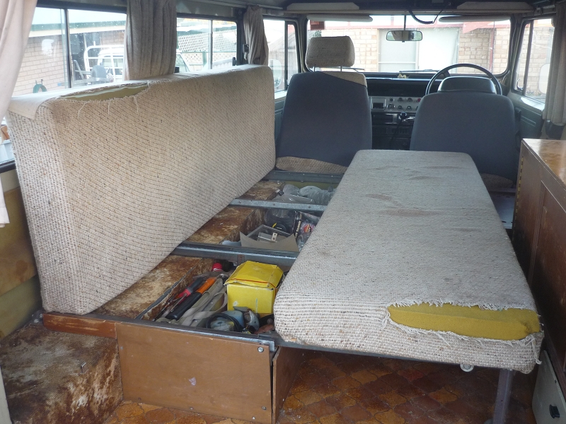

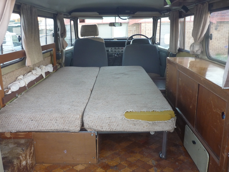

Here the bed construction:
So as you can see one part slides out and also gives access to the spare parts and tools underneath and the other part just folds down. Pretty simple and quick solution.
from the front

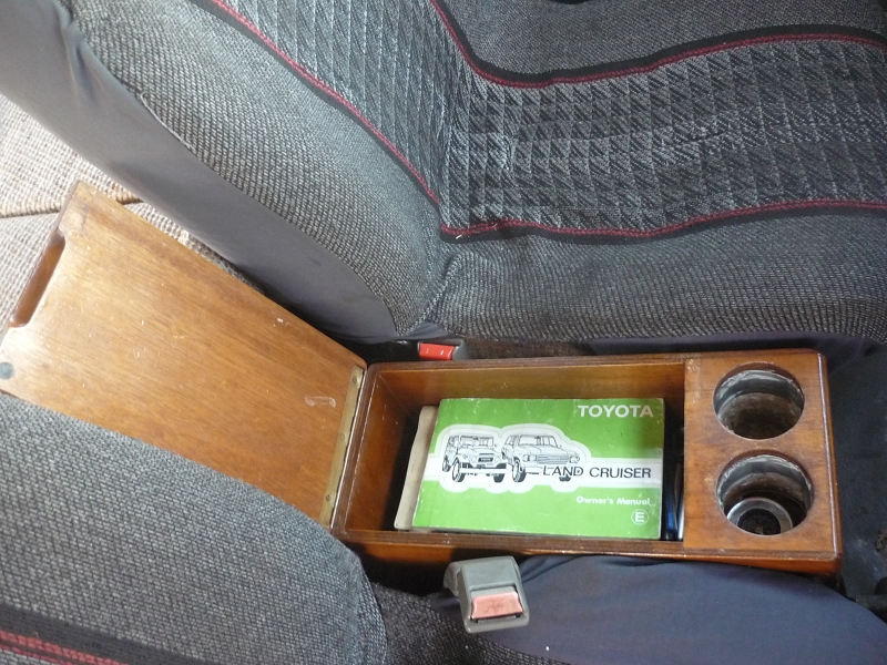

no 3 seater but a central glove box instead with drink holders :cheers:

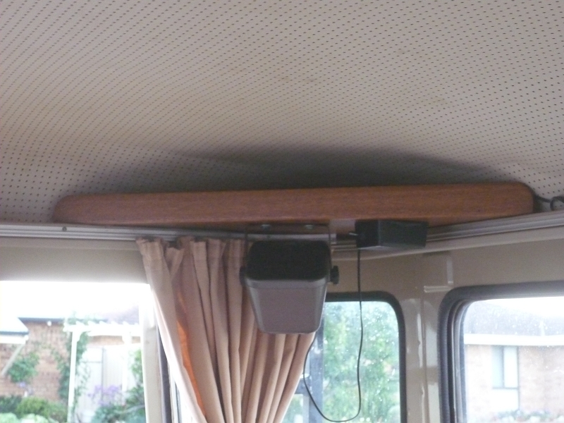

little shelves in the back, turned out to be very useful

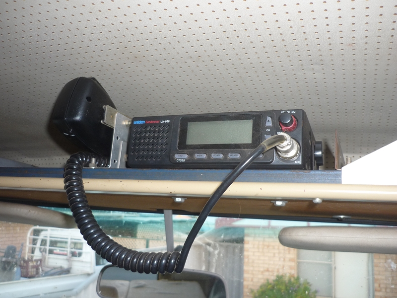

the UHF radio, so far never in use

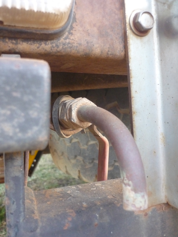

the water tap under the left rear door is perfect for quick dish washing

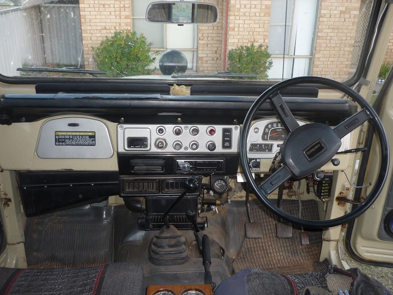

and the inside front view

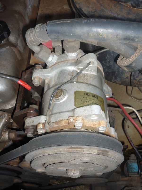

with a little aftermarket aircon

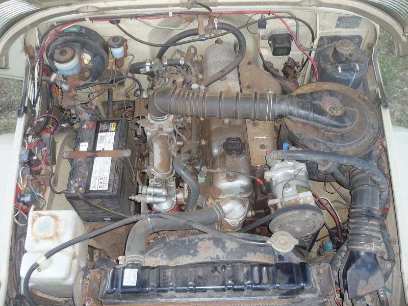

...and under the bonnet
Didn't get time to get a hiclone yet. Started to think about dual alternator now as I am planning to take it fairly easy with the distances and just like to stay for a longer time at one place when ever I feel like it. Anyone experience with that or other suggestions?
Thanks for reading and happy cruising! :)

For the interior I am planning to put in one bench on either side (just timber probably) with lids so I can store personal and camping stuff underneath. That would provide either 4 seats or 2 seats to keep it quiet comfortable. Then I definitely wanna be able to put a timber in the center so the whole rear of the car can be turned into a bed. Would make wild camping a bit easier in crowded areas or if it is just too cold to sleep on the roof. But really have to get into planning a little table construction for the center that has to be easily set up and dismantled.
Was also thinking about a lifting camper top or lifting the complete roof a couple of inches. First think would be quiet expensive if I don't manage myself and the second would make container and even ro/ro shipping complicated and more expensive. And I have to say I really don't wanna get rid of my roof rack, just too useful.

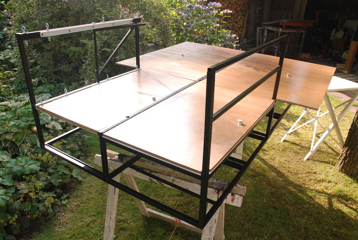

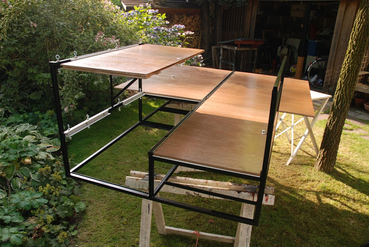

Here are some pics of my interrior:
I have plenty of storage room because of the boxes that can be placed under the shelves. And some bigger equipment can be mounted on the sides. Also nice is that i can take out the complete framework.
The disadvantage is that there is not so much roofspace and sleeping on an airbed on top of the shelves is not very comfortable.
A few months ago I bought a RTT and if we like sleeping in it i will rebuild my interior, but i still want to be able to sleep inside the car.
Last picture is a bit of a mess, because of a wild drive in Spain
Greetings

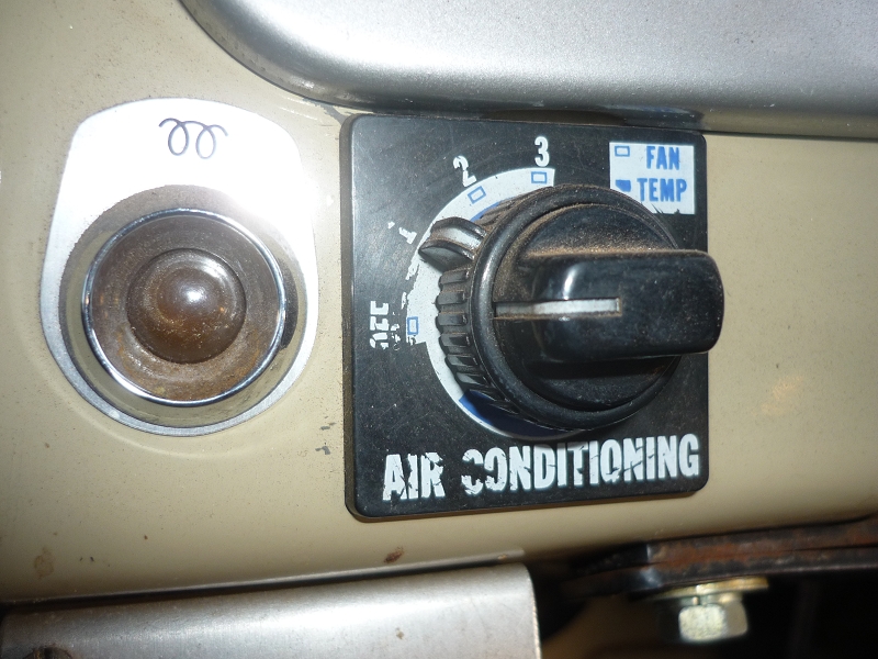

Very nice, that aircon isn't aftermarket, it's genuine Toyota, my '84 HJ 47 troopy has exactly the same system, actually works pretty well too. The switch actually looks the same as that on a new VDJ 76/78/79 Landcruiser, wouldn't be surprised if they were exactly the same. As for the floor covering in the rear, haha, funny stuff.
Pretty nice build you have there Johnny_boy. I agree with the idea of being able to take the whole camping setup out without much hassle. Especially because at least in Germany you are not very likely to get oldtimer number plates with a camping build. :)
How stable is your construction? Is it moving at all when you have the weight of a mattress and lets say two people on it?
I didn't know that the 47s where built with a factory aircon, thought just some swbs would have it. But good to know that it is genuine. It's a very strong unit in my case. Just don't use it too often as the engine is thirsty enough already. Do you have any figures of how much more fuel you use when the a/c is switched on, herbs? Would save me the maths. ;)

Thanks,
The structure is very stable, a little bit overkill for just two people sleeping on it, but now i am still able to transport something when i am not camping

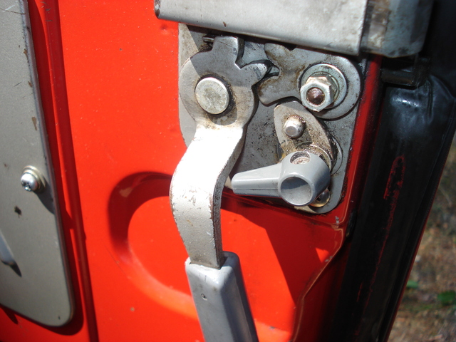

a) Would be nice if you can find two of these grey door secure knobs, unscrew them at the rear door of a troopie :)
at a wrecker for me and a hurnbutton with a chromring for such an old steeringwheel, mine have no chromring.
If you find them put it in your 45 before you ship your truck to Germany / I pay you the costs for the parts and pm you my adress in spring when you are back in Germany .
