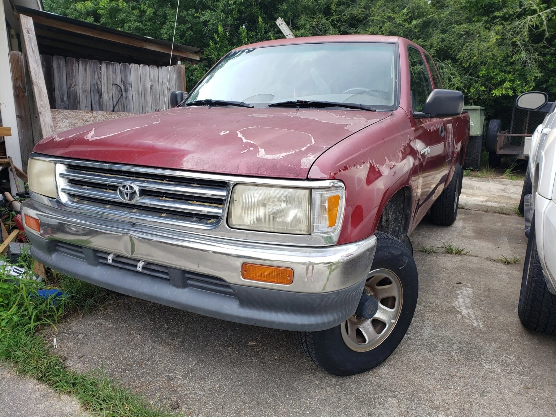

So I just picked up a 1996 T100 4wd base model and it is rough. The price was right (free) and it runs great, but everything is suspect - 240K miles, no service history. I drove it 120 miles today (yes, I had a chase truck) to get it home, and the following don't work - 1) the radio (aftermarket junk) 2) the A/C blows cool, but not cold. 3) the cruise control. Everything else seems to work great. And those are generic things that I will replace soon.

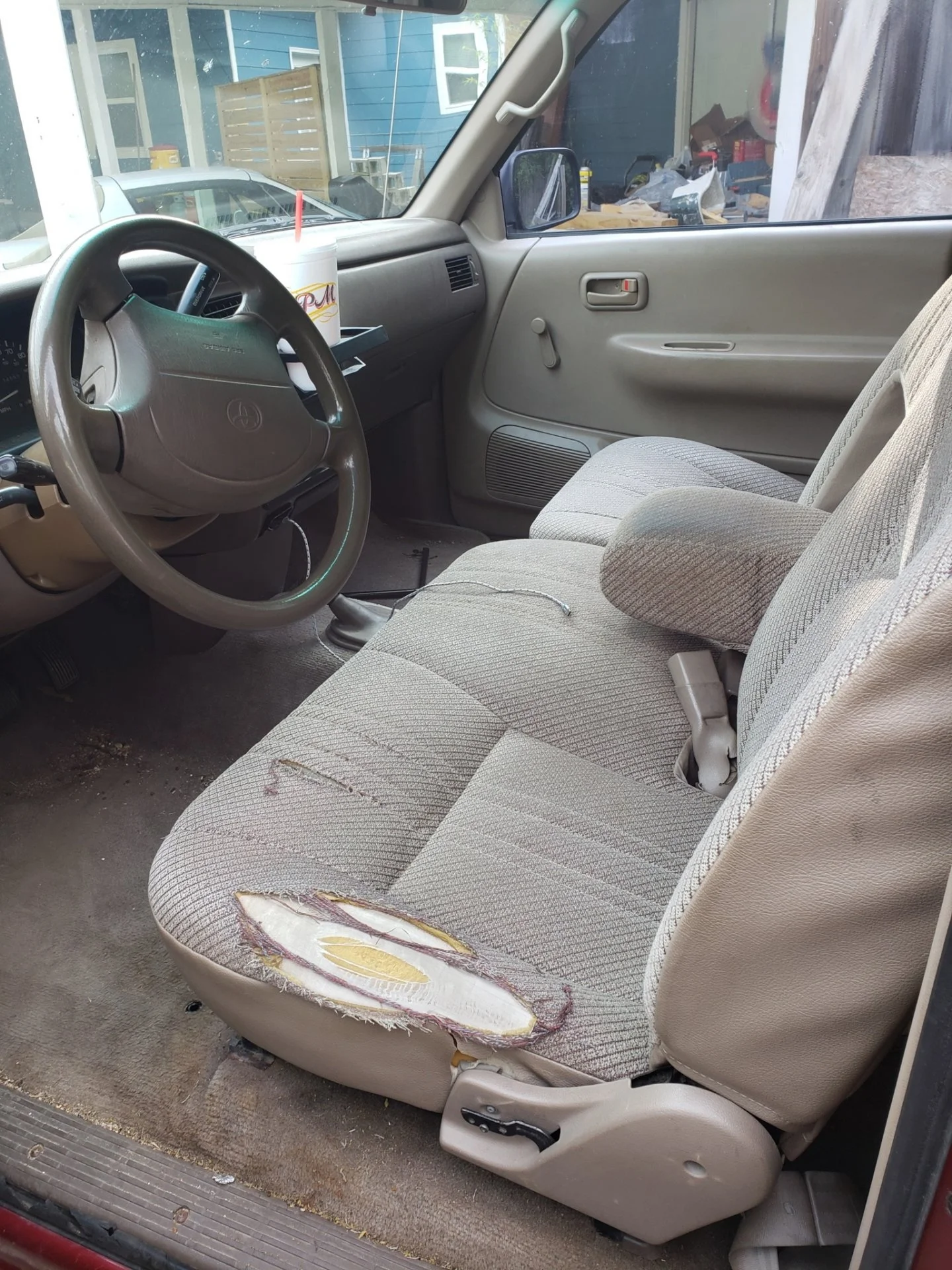

2) The seats suck. What fits?

2) The seats suck. What fits? Nothing directly fits anything will need modification. About 300 to 400 per seat a good shop can rebuild what you have auto upholstery

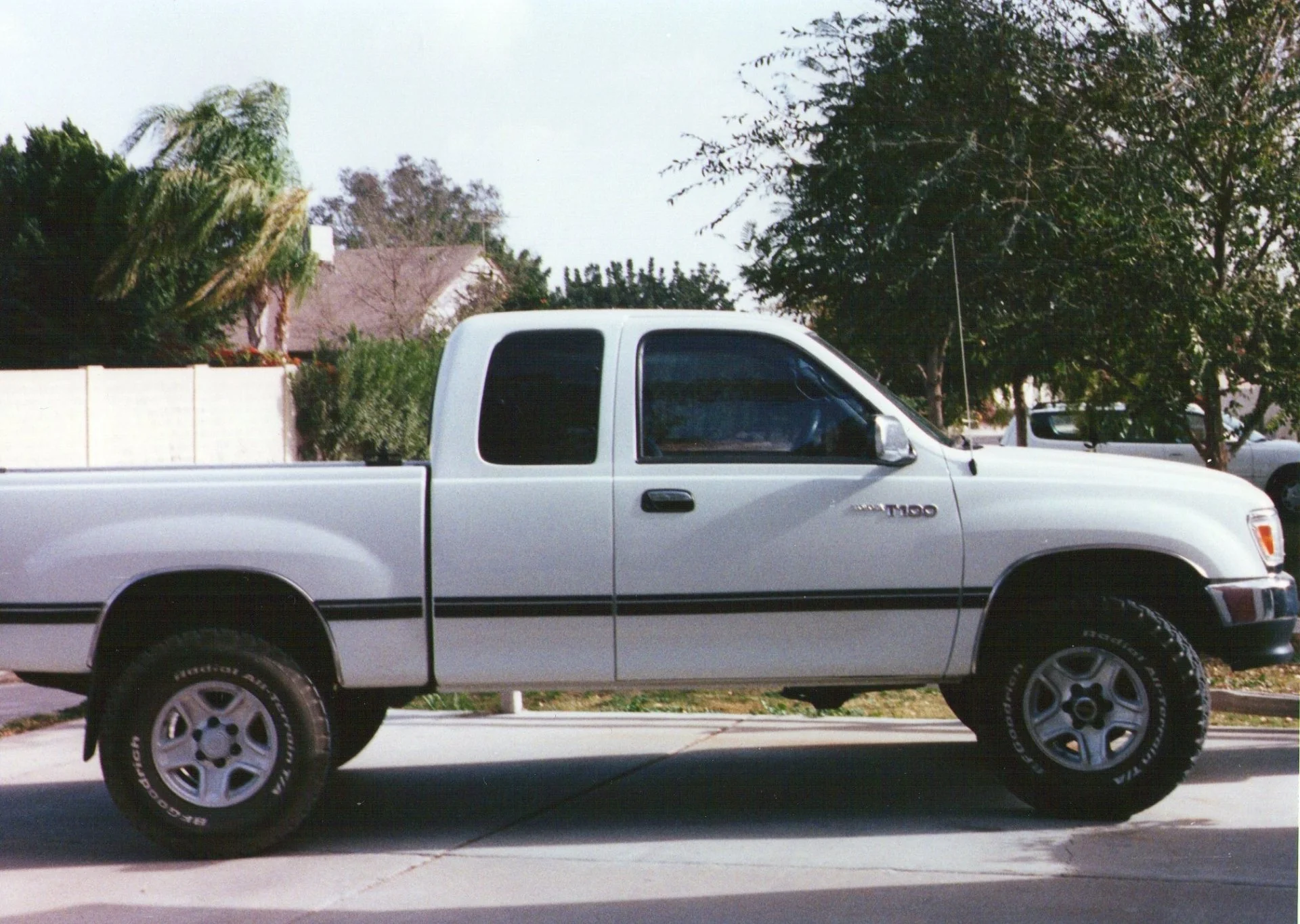

This is picture of my truck factory suspension with 285/75/16 tires. I was able to go just about any place I wanted minus major rock crawling and that was more issue of open diffs. Good Luck.
Yours looks great! I am looking at the Superlift 4-5 inch lift (and probably a rear spring swap rather than the blocks) along with a small body lift. I think that 35's are doable with that and a possible re-gear. The clearance would be useful for some of the paces that I will take it. First it will be full general mechanics/tune up.

2" body lift and some trimming and you should be able to fit a bigger tire. Maybe not 35s. Does someone make a ball joint spacer for up front?
