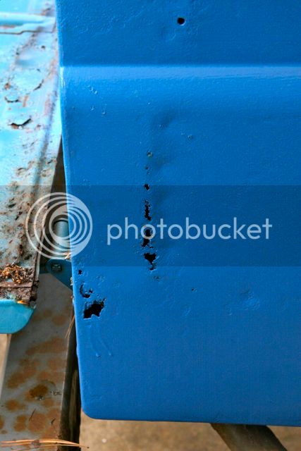

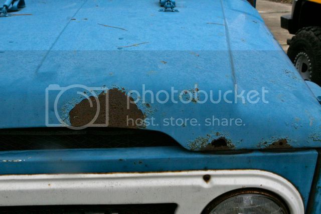

The whole hood needs work with stuff like this, probably be smartest to just replace it...

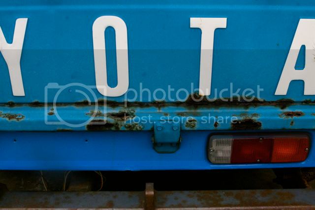

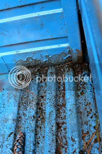

The bed and tailgate are pretty rough...

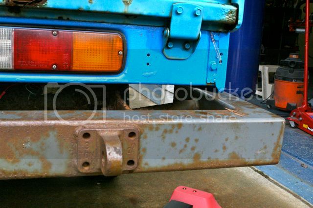

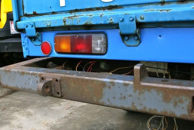

Here are the pics of the rear bumper for Darin (if you need more Darin, let me know)...

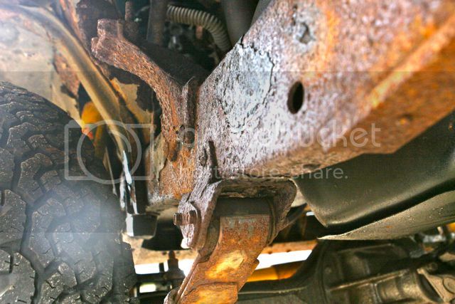

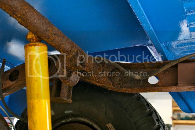

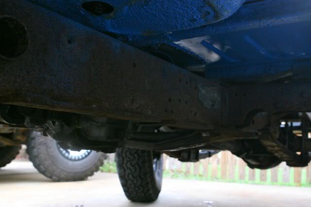

Frame pics...

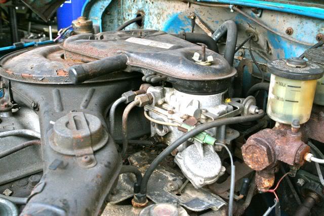

Now for the engine bay pics...

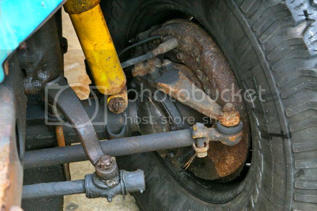

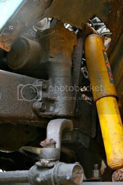

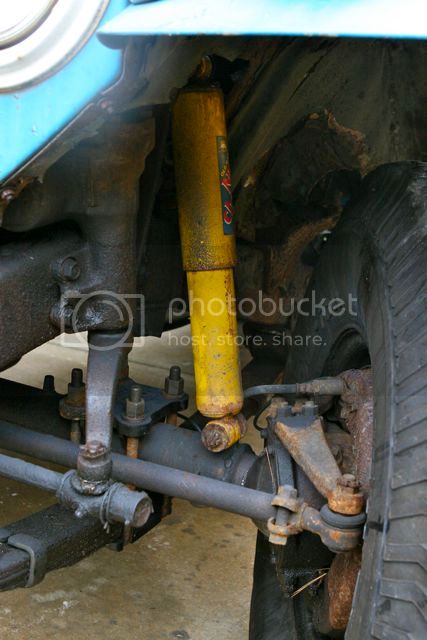

Front knuckles look fair and not dry at least...

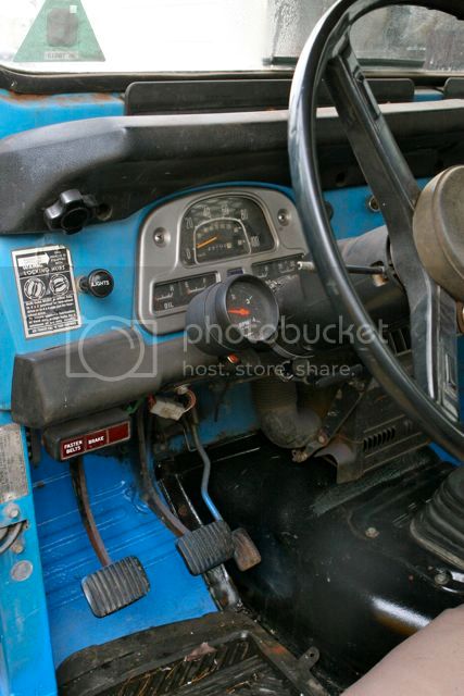

Interior...

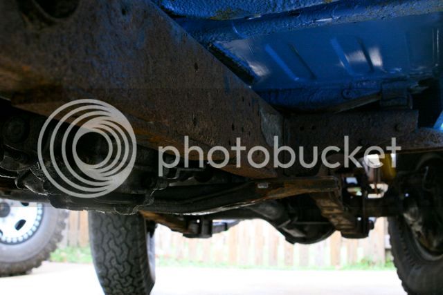

Only thing that looks really problematic is the amount of frame rust. Can't really tell from the pics though just how bad it is.
congrats!
Thanks Del. :beer:

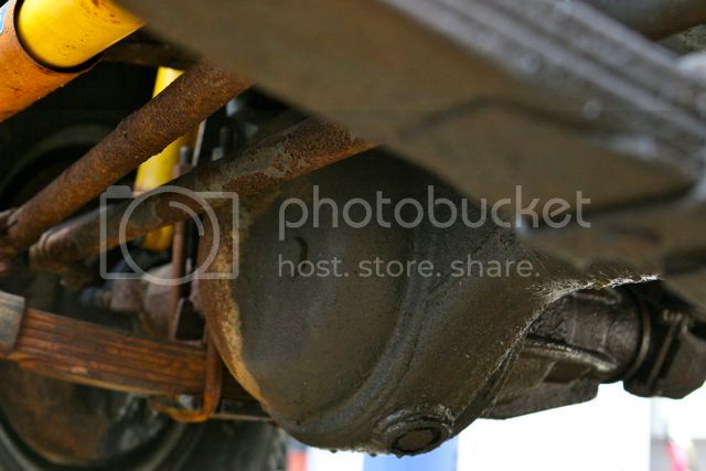

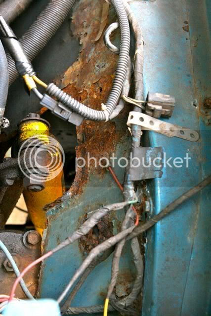

I went out with hammer, punch and wire brush in hand to see how deep the rust is on the frame.
I couldn't find any soft spots or punch through any metal on the frame or cross-members. I started on one spot of the cowl as a test patch and I can see what I'll be doing for the next few weeks/months to get it cleaned up...

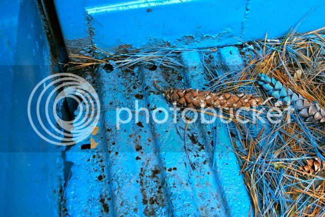

For beign a Land Cruiser and a Northern Truck it could have been a lot worse. I think you may find more rust in the body and frame then you see right now. Basing this on the blue pine cones :D.

Blue pine cones, pine needles, light bulb...he didn't clear much out when he painted it. All that was done when he replaced the front floor boards and patched up the truck bed. I'm pretty much resigned to be building a new bed and storing this one in the event I try to restore it.

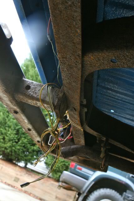

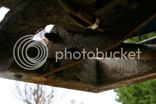

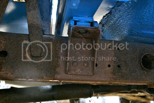

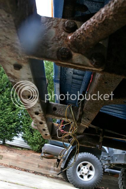

Has had some patch work where the rear springs attach to the frame. Might want to look really close at the frame.

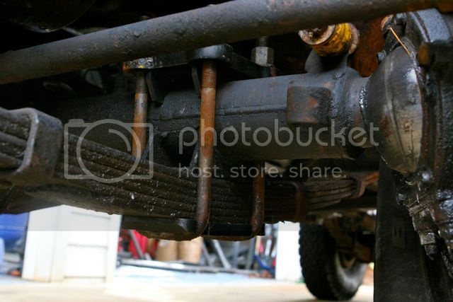

I gave the frame a real hard look and don't know why what was done. There is some boxed in sections up front near the crossmember, which is from a 60 (assuming due to the split t-case). And, those spring hangers are kind of sloppy IMHO. Not sure if it was due to damage or the installed springs. I'll have to measure the eye-eye of the springs to see what they are.
I plan on stripping the frame down as best I can short of removing everything, unless its so bad that I have to. The parts I hit with the wire brush cleaned up nicely with solid metal under all the crap. Regardless, no doubt I'll give it a very close inspection as I get things cleaned up under there...

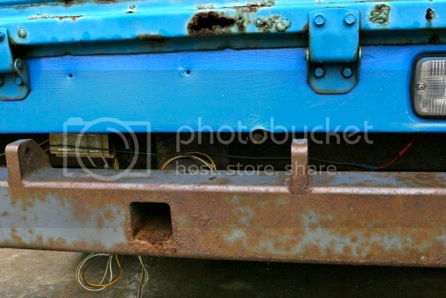

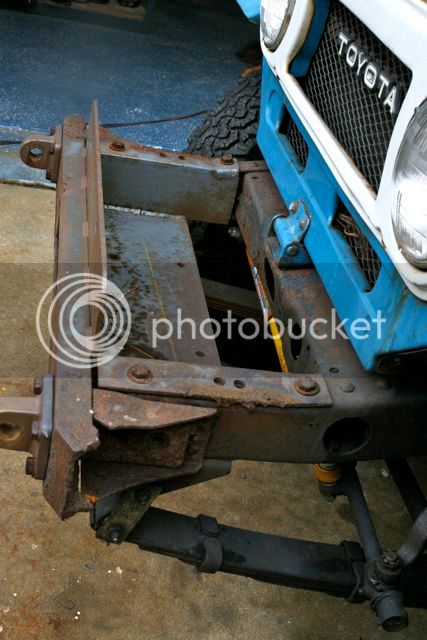

Jerry, might send you a picture of where i need you to take a pic of and see what they did for hooking that bumper to the frame there.
Ya'll getting cold in your garages ?
What is that nonsense ?
Got a nice new heater in mine. Got to have it cycle or it gets too hot. Went and got 2 8ft workbenches now also.
Yeah, I've got to find something for sure.
I'll go take some better pics of that area, its pretty straight forward from what I recall...
