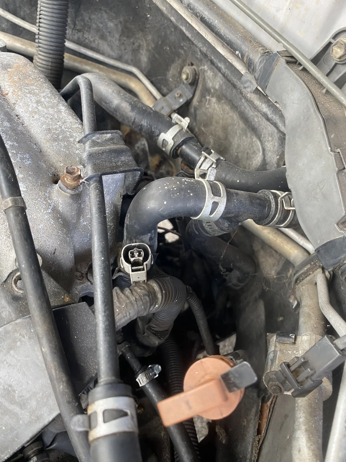

Other notes: there is only one plug that is not connected wich i will include a picture of. also the truck does not have cats, o2 sensors are still there tho.
