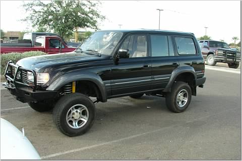

47b5ce29b3127cce94288784330000000016108BZsmrlm4bq
You be the judge.
You will love the lift!!!
I will try that line no questions asked:grinpimp:
You be the judge.
I will try that line to questions asked:grinpimp:
WOW that actually looks pretty good even with the stock tires.
