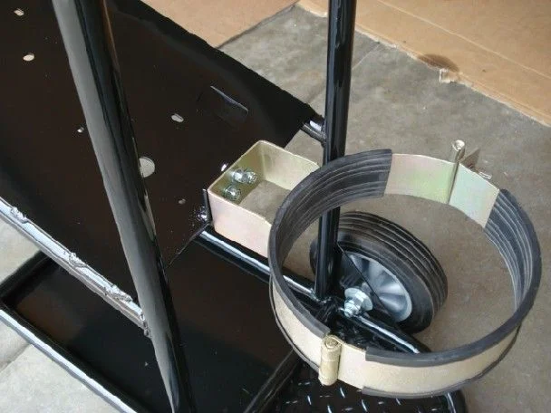

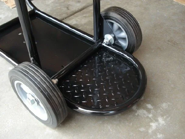

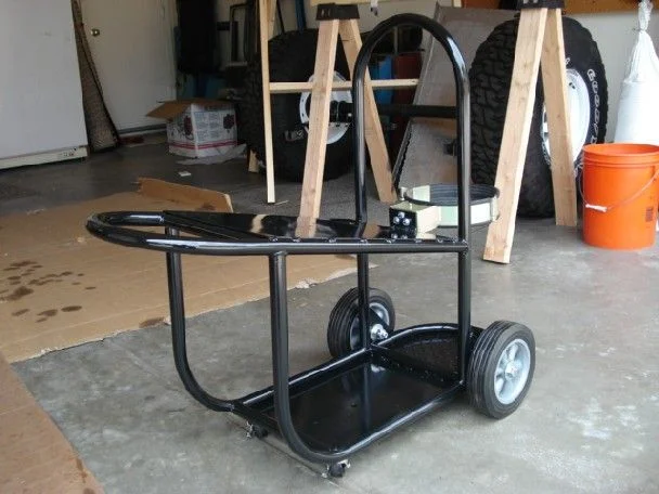

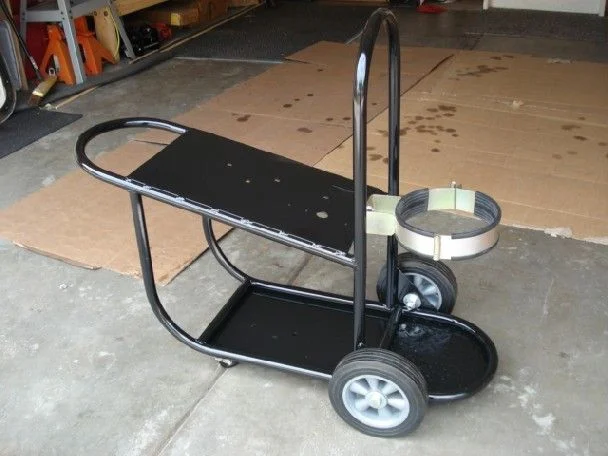

Got the cart done last night, I have to put the wheels back on but it is in paint and looking good. Here are a few pics, feel free give any feedback on my welds, I would appreciate it.

Not bad...Least you didn't blow any holes:D(I have a tendency to do that from time to time);)
Here it is all done up and ready for years of abuse, or at least a week or two until my newbie welds fail :D

Yeah.... It looked like s*#t before but with that paint, it looks much better!
Kidding, of course. Very nice job. Low to the ground, good center of gravity, compact and easy to wheel. Nice job dude.
Looks so nice you kinda hate to put anything on it that might scratch it! Armorall those tires, man.

Well, today the chop saw covered it in sparks so it is broken in already!
I might seriously amorall the tires, and chrome the centers! :D
