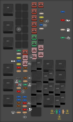

That’s where I’d start. Not sure if yours (OP) is the same but my 2015 manual says fuse 36 in the under hood box.
I get this is a thread revival but posting my issue that I had and how this thread resolved it. I have a 2015 LC and both my memory seat button AND my drivers seat would not go up or down. Move the button/switch up/down and nothing. Driver seat would go forward, backwards, lumbar, and recline but not go up or down (see pic). I checked both fuses in the cab - fuse 25 (30A) for RH power seat and fuse 30 (30A) for LH power seat and both were good.
This 5A fuse referenced above in slot 36 fuse box under the hood was blown on my rig. Replaced it and it fixed both memory button and power seat up/down function. Hope this helps someone else down the road.
Fuse locations
