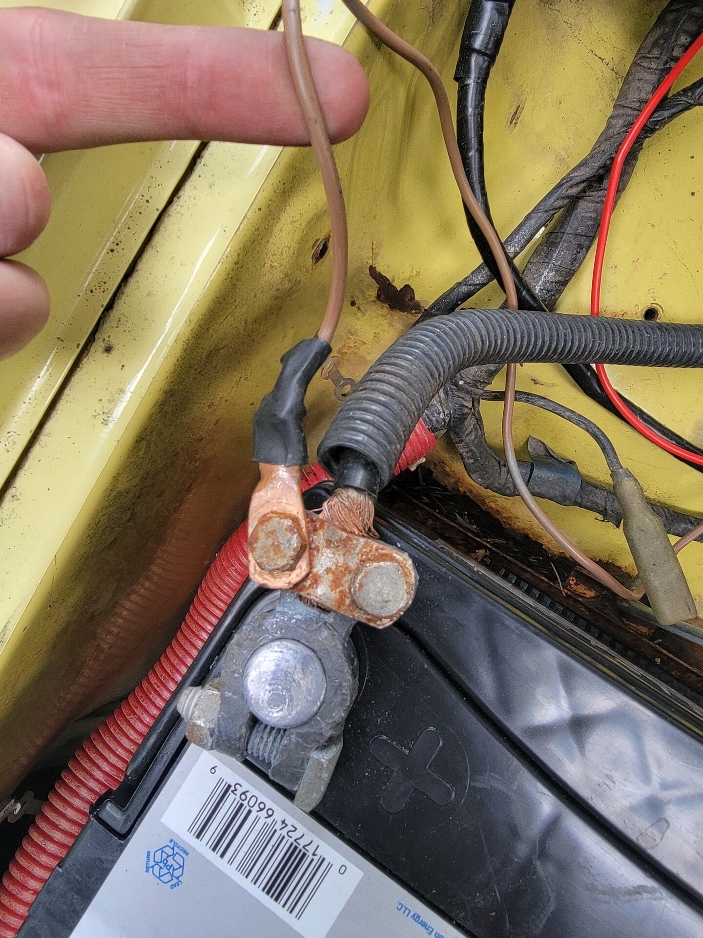

The wiring. My God the wiring.
The corner lights were scotch lock spliced into a random harness when the functional factory wiring is in place.
The msd had brown for hot and red for ground
The blower motor was wired into the cigarette lighter circuit which was missing.
It has LED's in the dash that caused all the lights to flicker.
The tail lights are aftermarket and boy did he **** those up.

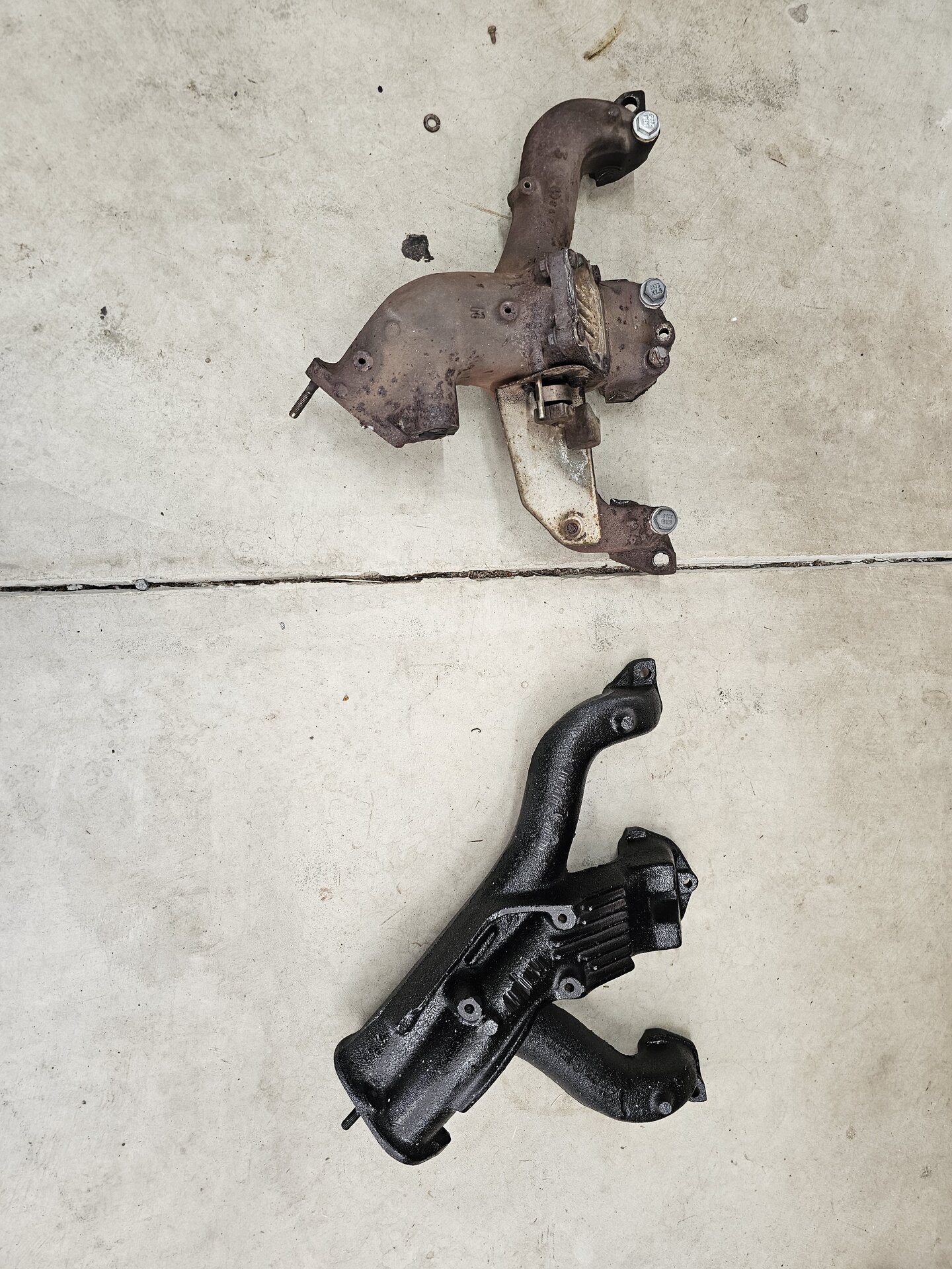

The 77 has emissions and it's been deleted poorly. The exhaust and intake manifold are tied together so if one was going they both were.
In comes a cannon intake manifold that is designed for the Weber rather than needing an adapter.
I also acquired a exhaust manifold off an L16 truck. It's a 4 in to 2 manifold and as good as any header on the market without a worry of leaking.
I soaked the manifold in clr for a few days and will paint it high temp to keep it looking nice.

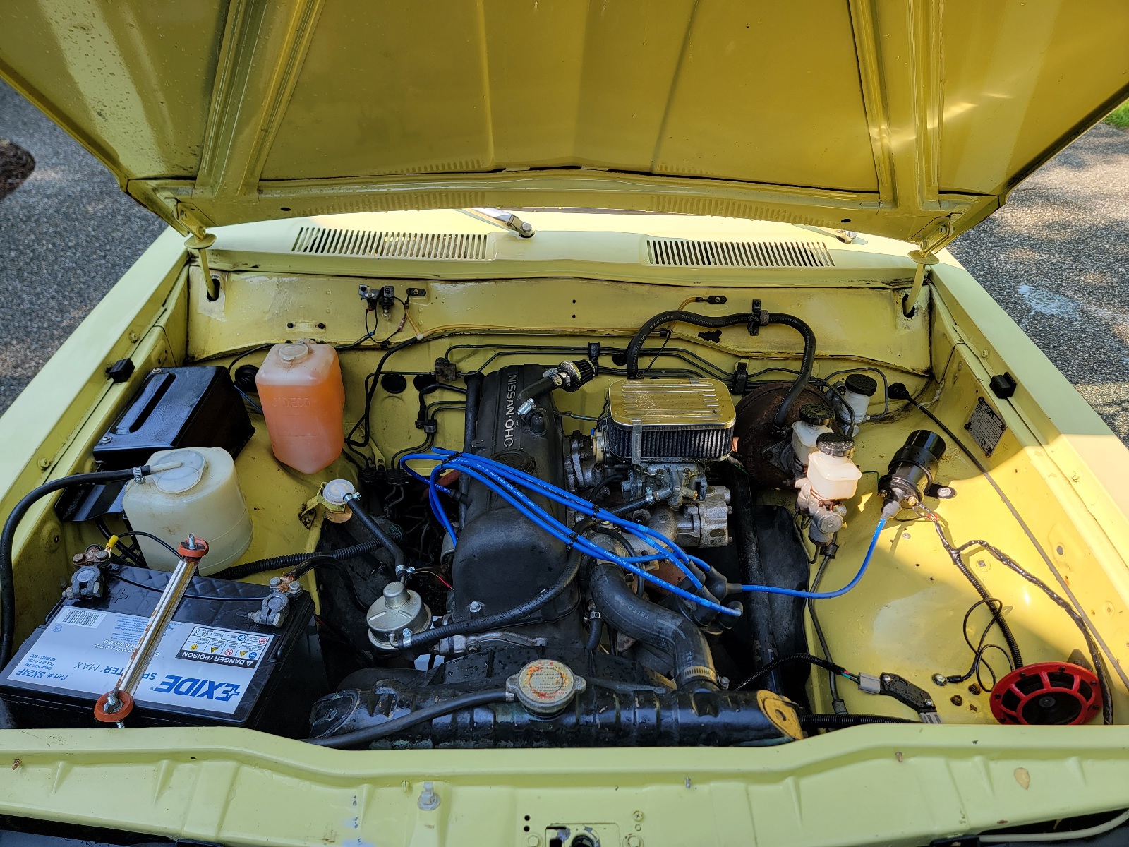

I've cleaned up the underhood. Painted some of the red to black. Fixed the horn. Fixed washers. Cleaned up the hei module wiring and washed it.
I have wheels due Friday and new tires. I'm going to lower it 3" and put the wheels and tires on this weekend so I took some before shots.
I have an OEM replica leather shift boot on the way too. Very excited for that.

Exhaust manifold

New exhaust including a custom y-pipe(stock manifold was a single, this is a 4-2-1)
