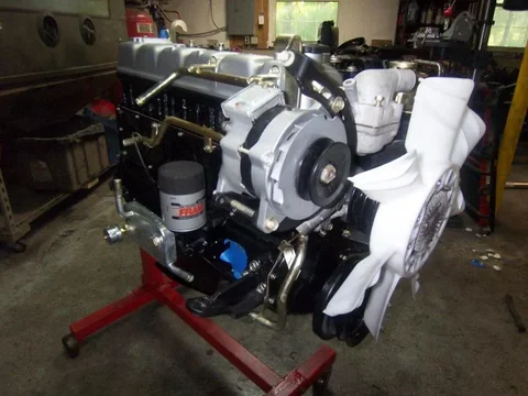

Now I've got a question for somebody.
I'm planning on re- installing Timing Cover and Crank Pulley. I'm ready to go but trying to figure out small brackets on backside of timing cover.
FSM shows longer bolts when using an oil cooler, but can't find any good pictures showing how this went. Can anyone snap some photos for me?
Got some washers cut in half and set wit JB weld. I'm going to try this route first.
That bracket in your hand is for the fuel line. It attaches to one of the timing cover bolts. I think there may be a little steel spacer (about 1/4" thick) that separates it from the front of the cover, too.
Splangy...thanks! your right I'm sure. Now that you mention it, I remember the spacer, but not sure where I put it.
But my original question was for the tube that goes from Water Pump to Oil Cooler. You sent me this picture which shows the part perfectly!

I can't find a part # for the copper crush washers for oil cooler. Can I just take this to parts store and find same size or does anyone know a part #?
Should I replace these on all bolts that hold oil cooler to block?
What would be length of 4 bolts that hold the oil filter to the block?
