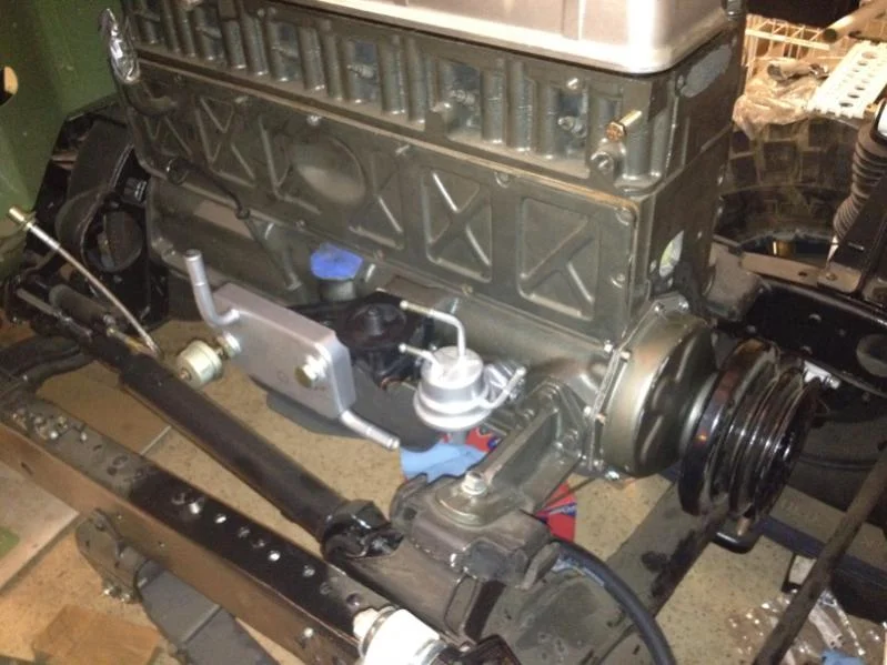

Put the timing cover and crank pulley back in tonight. Hope the bolts are tight enough!
My inch lb torque wrench was too fat to fit on bottom bolts with crank pulley on, so i just guessed and tightened by hand.
Fuel pump and oil cooler installed.

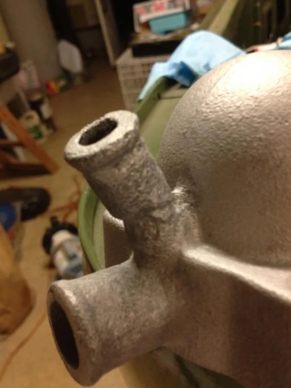

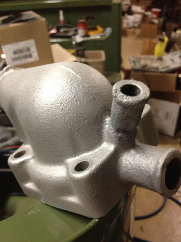

Careful with the housing. My shop dropped mine and it broke in two. He couldn't source one so he essentially jb welded it back together. Looking good! Keep up the good work!
ky My thermostat housing was badly pitted as well, I did that exact same thing you were talking about with jb weld. I thought It was crazy but it turned out beautiful. I had it powder coated gloss black...
How about some pics?
Good idea. Here's mine.
I may use All-Metal filler since I have some.
