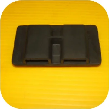

2. Anybody know the Toyota Part # for 2F Clutch Inspection Cover Plug?

Clutch Housing Cover, Toyota Part # 31121-60021
