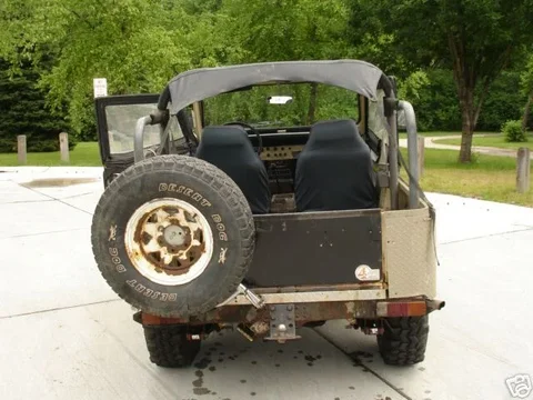

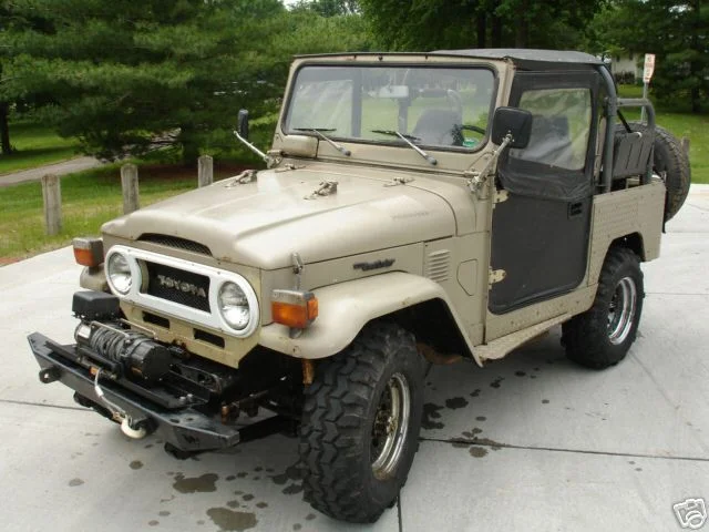

I purchased my '81 FJ40 on eBay in June of 2007. It's not my first Land Cruiser, I've owned an ‘83 FJ60, and a '98 UZJ 100 but sold both (regret this now). But something about the 40 series that I just couldn’t shake. I had to have one. Back to the 40.
It was an impulse buy. I was the last bidder and won much to my surprise. I had decided I wanted a late model FJ40, but can’t really tell you why. In fact this decision was made with no research at all. A decision I would soon regret.
The guy I bought the 40 from was from St. Louis and, if you don’t know by now, I live in Kentucky. I researched the cost to have the truck shipped, approximately $500, but the seller was anxious to get his funds so we decided to meet half way in Evansville, Indiana.
So a buddy of mine who is into Mopar and has built several vehicles agreed to go with me to Evansville with his car hauler and bring it back home. We met the seller at a marina on the Ohio river. My expectations were thrown when I saw the truck close-up. It was indeed the same truck in the eBay description, but the description was way off on the overall condition of the truck. It had diamond plate everywhere and had mud in every crevice you can think of. However, I knew I has stuck by eBay standards so after test driving the truck and going through some formalities I handed over the agreed upon cash and loaded up the truck on the car hauler. That’s when the fireworks began.

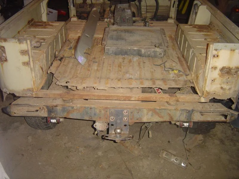

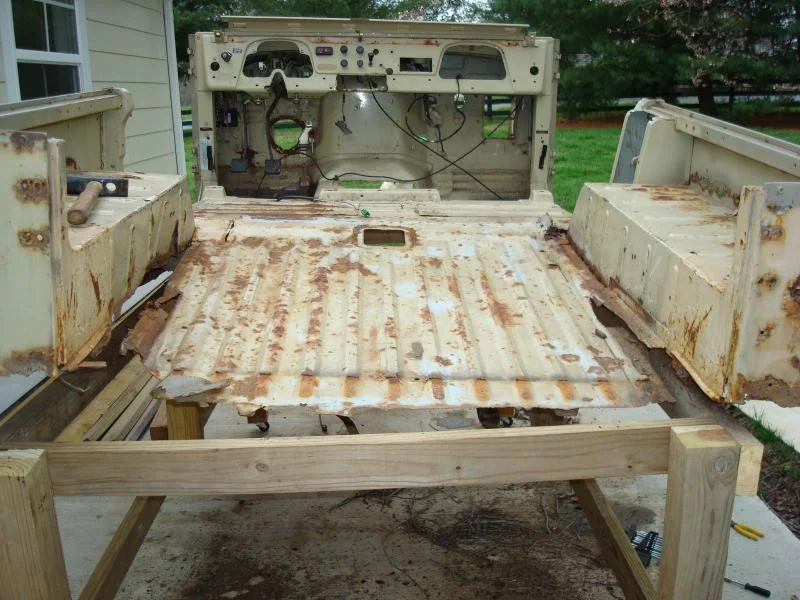

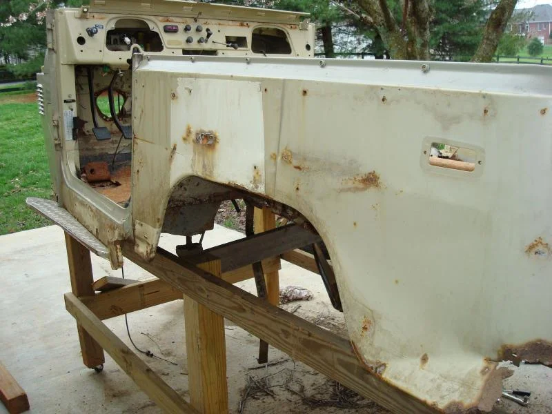

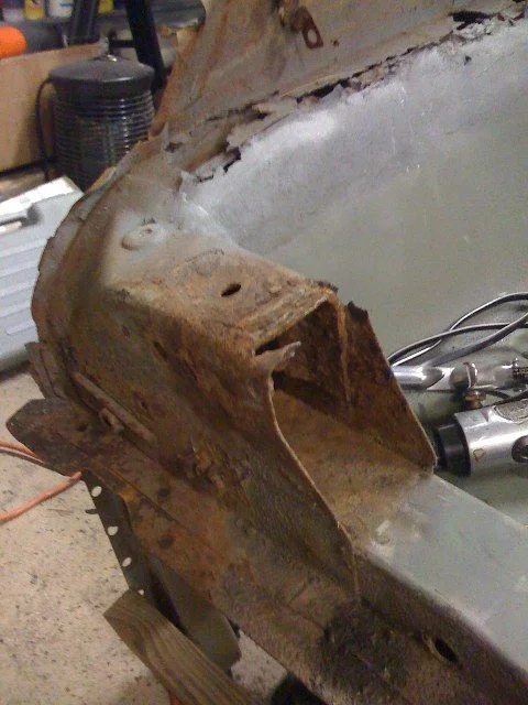

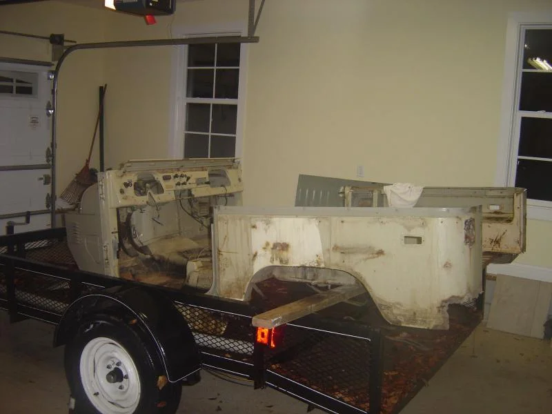

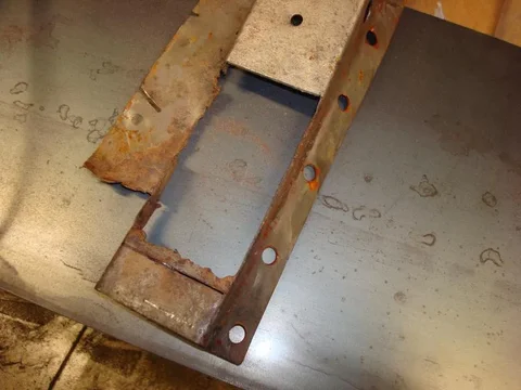

Word to the wise, if you plan on taking one apart be prepared to find some nasty rust in every seam. Especially the front tub to frame body mounts, the mid body tub bridge and the rear sil. Almost always this rust works its way into the front floor pans, rocker panels, wheel wells and kick vent panels. Basically my 40 was rusted through from the front firewall to the rear amby door opening.

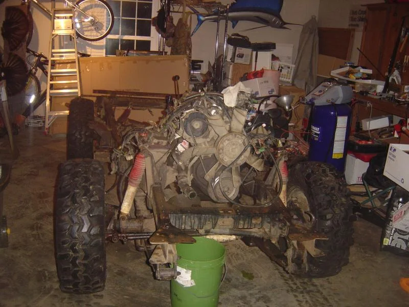

Originally, the MOPAR friend that helped me pickup the rig also agreed to help me fix up my 40, but in between working on his junk. He was working on a 60-something Plymouth Satellite, and my rig took the back burner.
So while I was waiting I started researching everything.
I bought a Mini Truck PS kit from JTOutfitters, and some headers and a Weber 38 from TPI4x4, since they are practically in my backyard.

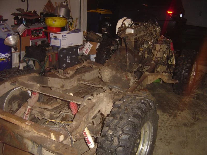

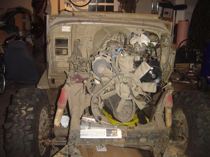

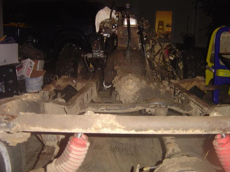

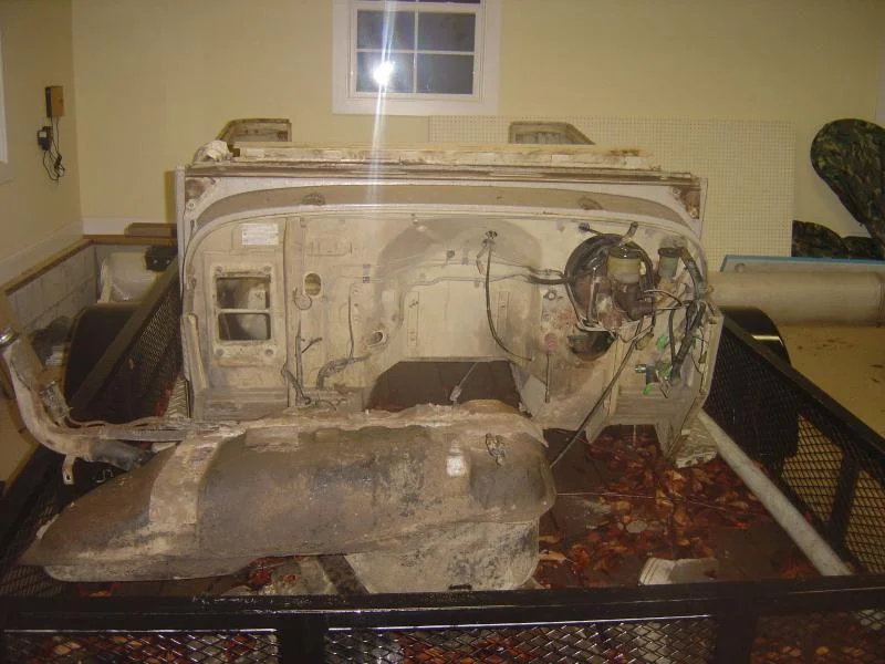

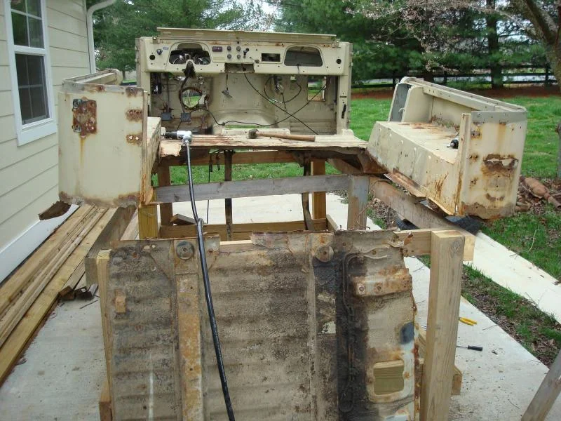

Tired of waiting on my buddy, I started to remove the 1/2 tub from my truck. I wouldnt do this again...
In fact I would have repaired it on the frame first before attempting to remove tub.
I also learned that my front body mounts were rotted away which in turn rotted the front floor pans. One of the PO's had welded in some temp floor pans but they looked horrible so I cut them out. I had begun a never ending journey into rustville.

While researching the front body mounts I found www.pacolonline.com. I finally found a vendor that sold weld on body mounts! They also produce the mid-body tub bridge which is also prone to rust in late model 40's. So if any of you guys are looking for these keep this in mind. Oscar at Pacol is SUPER to work with so give him a call.
I also bought some full quarters and bed from pacolonline. Now these are made of some heavy guage metal and very well made. Also, they didnt try to bend me over on the shipping, which I really appreciated. At the same time I bought a rear sill from CCOT.

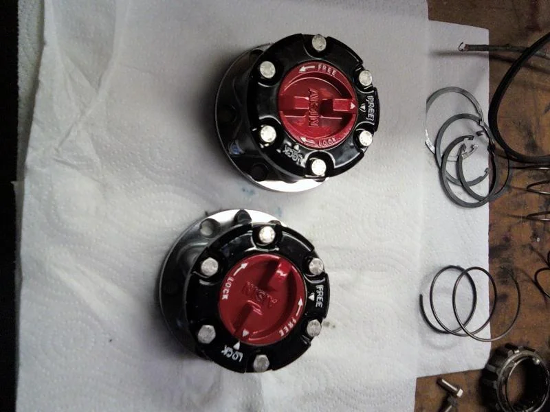

While I was waiting and researching my new addiction, I decided to crack open my diffs. This is what we found in the front. It appeared to be welded and full of water at some point.
so I posted up here on mud and found a new used 3rd. Thanks Kieran!
Also many thanks for powder coating my AISIN hubs!

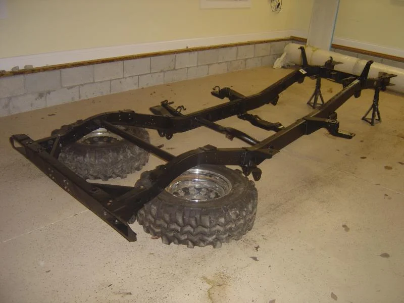

I had my frame painted by some local yocals, but have since decided to take to sandblaster and get frame powdercoated. In the time since frame had been painted some rust had started to peak out from underneath the paint.
Below is picture of frame after paint.
