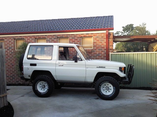

OK, So I have been a little slack, but here are a couple of pics:
I have gained about 4'' over what it was, goes to show how sagged the old stuff was:( This OME kit is specified as a 2'' lift. Drives so much better now. I also got some 33 x 12.5 x 15 Maxxis Buckshot's and new white sunraysier's but it got too dark to take a decent pic last night. Pics to follow;)
The Buckshot will really make a difference.;)

looking good for the height mate
what happened to the bridgestone desert duelers from the top photos
Well here is the pic. The Duellers in the first pic I borrowed for its first outing.... The Gas filler is in a stupid spot, it collects mud....

How wide are the rims mate looks like a nice offset

The rims are 15 x 8 and ET23 offset. They fit really well, although I may need some small flares later on to keep it 'legal'.
