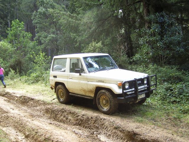

Greetings all, new member here from Melbourne Australia. I have just picked up myself an FJ70 with a 3F. I plan to do some light modifications to it over the coming months.
Cheers Brad.
top ride mate
is it on gas little red tag on your plate ?? were does the tank live
Yeah she's on gas. The tank is at the back underneath, I think where the fuel tank would have been. The fuel tank is now in the middle of the car under the passenger side. In that pic, the gas tank is resting on the ground!

Looks like a no/low rust body you got there;) They are getting hard to find in *J70 these days.

The body is neat, there are a couple of spots of surface rust, but that's it.

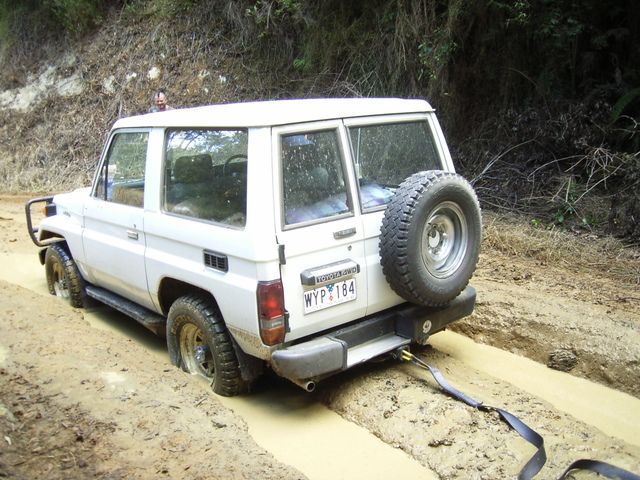

You dont need much of a lift to handle 33s. I have a 33 BFG A/T in this pic with a Dobinson 2 inch lift and it has never rubbed
